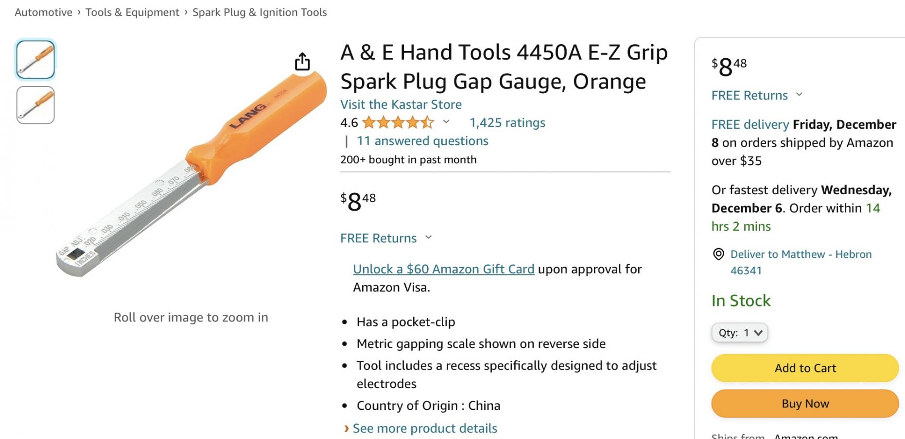

If 3 were ngk and 3 denso, then yes original from the factory. I switched mine to denso iridium gapped to 0.034”. Runs great and will never wear out. The originals were still in at 220,000 miles and gapped over 0.070” but the engine ran just fine. Its running smoother now of course. And yes you can gap iridiums so long and you dont touch the fine electrode. If you dont gap them, they come gapped too small from denso, your engine wont run right.
Spark Plug Installation | DENSO Auto Parts
I use this tool to gap the plugs. Use the hole in the end to lever open the ground strap.
Curious, why are those gapped differently?
