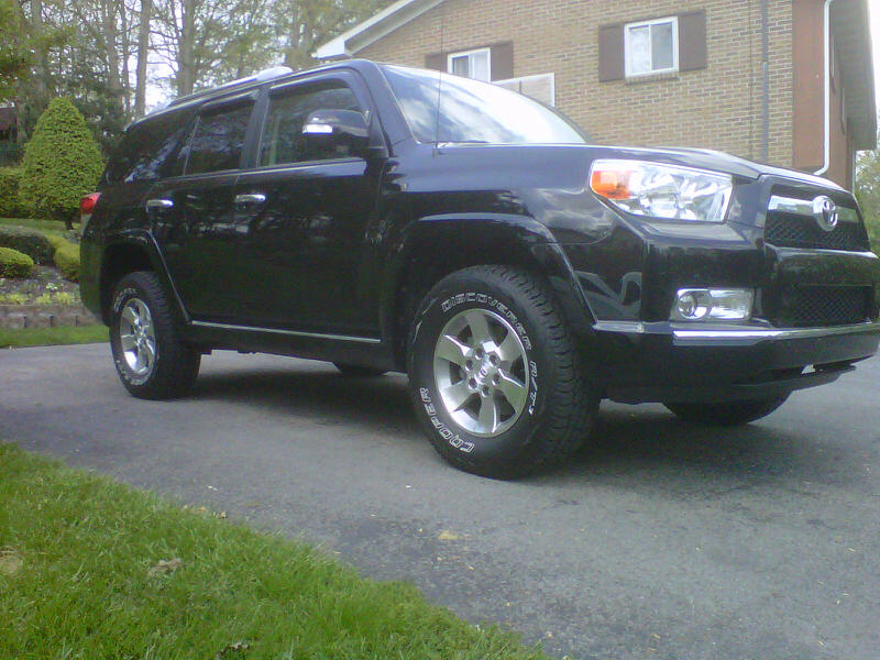

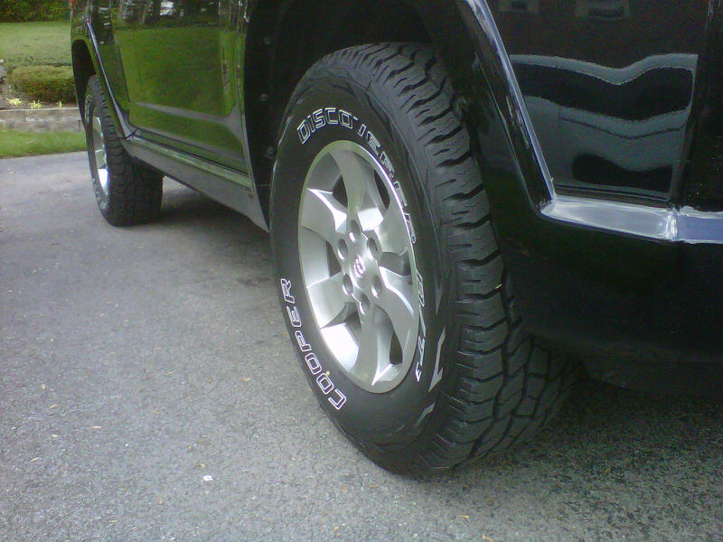

I won't re-hash all of the advantages of getting new tires. My original Bridgestones lasted 32K and were getting very worn. I could have gotten realistically 3-5K more but that would have been taking it into the danger territory.
I decided on the Cooper Discoverer AT3. I kept the stock size and passenger rating. I do not need nor want a lift and P is just fine for my off roading. I do not rock crawl or anything.
There have been a few on here that have purchased them and Okki has the ATP. I drove 475 miles with them on a trip this past Sunday. Very quiet and handles well on the interstate. I took them off road Sunday night for about a mile. It was not too muddy but enough to put it in 4H. The tires, as expected were superior to stock. All in all I am happy with performance and definitely happy at the price which was less than $750.00 out the door including 6% sales tax.
Anyway, here are a few pics.

What are the dimensions on those? 265 or 275? What's the widest you can go without spacers? Like you, I don't rock crawl, I just do some dirt roads and fields occasionally. I don't have a need for a lift kit, but want to get rid of the soccer mom look and make it all terrain friendly.
Thanks for the review/pics...I'm trying to decide now what I'll replace the stockers with when they wear out.
I'll more than likely end up with a leveled front end and these look like they'll fit the bill nicely.
They're certainly now on the finals list.

Now, to address the tread width, not to be confused with section width. If I measure across the tread I get about 8 3/4". I measured the tread width on my OEM spare and it was about 7 5/8". So my new tires are over an inch wider across the tread. It is difficult to determine the exact tread width on a tire as the radius of the shoulder rolls into the sidewall. I measured to the middle of the radius.
