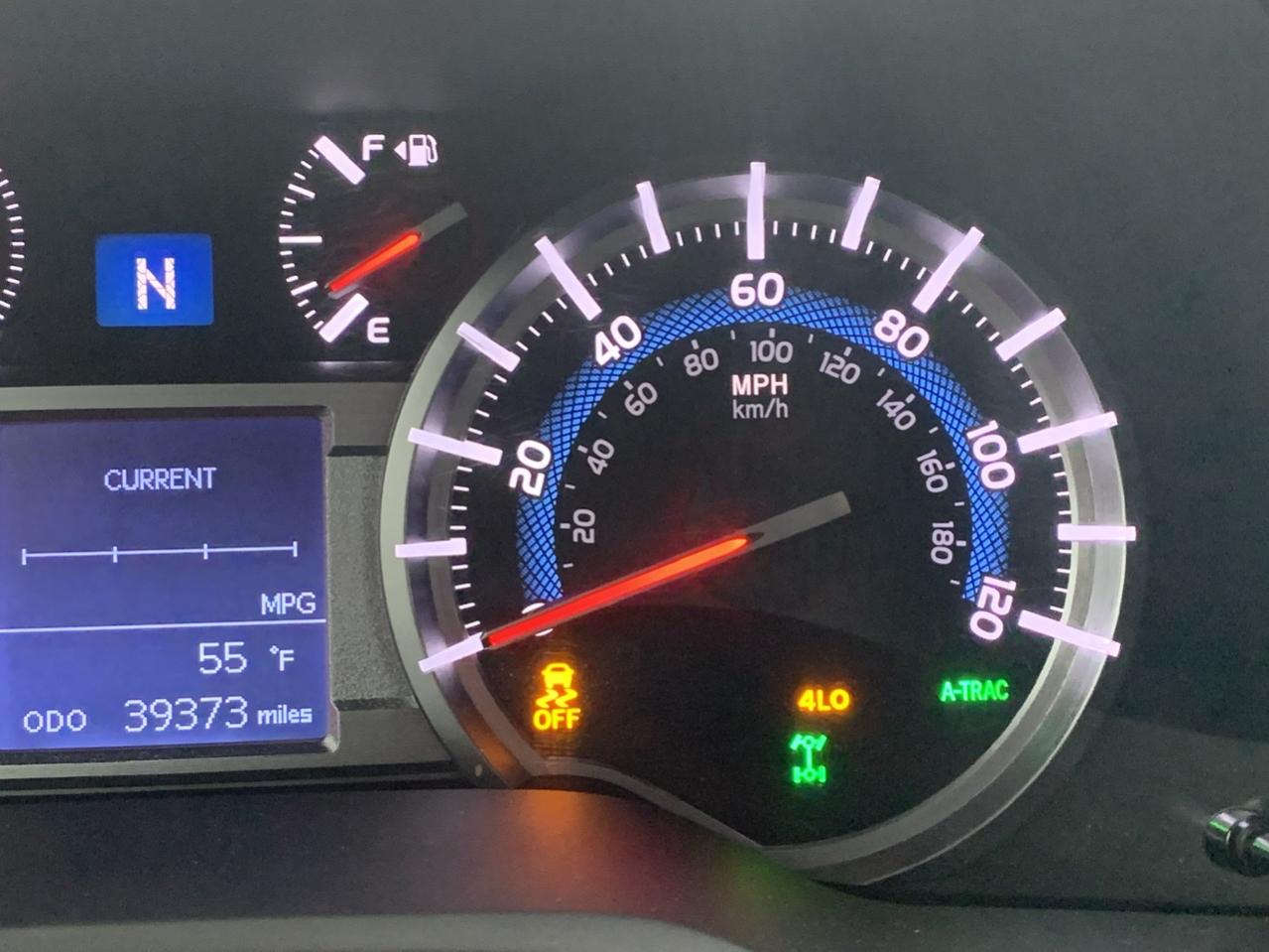

UPDATE:
So, it’s working.
Went to the dealship for the airbag recall and had them check to make sure the ATRAC wasn’t jacked up.
I had the mechanic go through the same sequence that I went through. Neutral, 4LO, let it engage, then ATRAC. It all came on. Not sure what the deal is/was. I was sorta thinking it was user error since I rarely need atrac and forgot the sequence but that wasn’t the case. I guess the rig just needed a little scare to get it to work or maybe when he ran diagnostics on it, it triggered something. Who knows…
That said, I’ve also never seen the 4LO light and the traction control(off) light come on while in 4LO either.
Anyway, good news!
