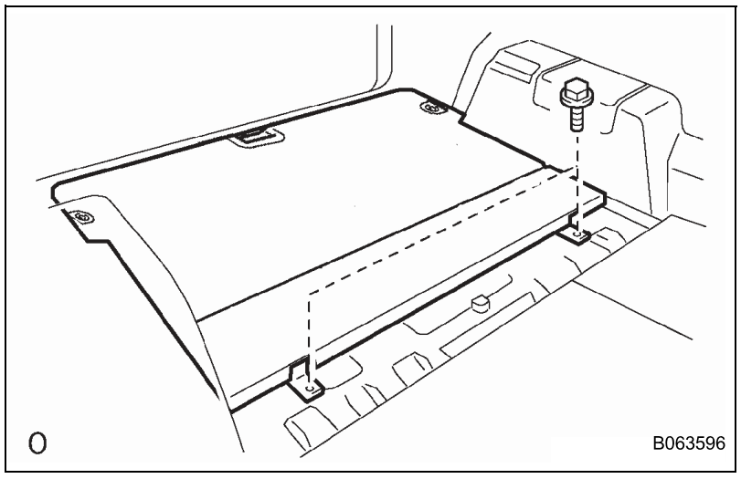

To fasten down my Drawer system I removed the plastic cargo shelf following the Toyota Service Manual (Pic Attached)
With that removed I bought slightly longer bolts from the local Ace/TrueValue hardware store (Lowes and BORG did not stock this metric thread in my area).
If you remove the 2 plastic trays with the D-Rings behind the Rear wheel wells there are 2 more factory mounts available to tie into.
