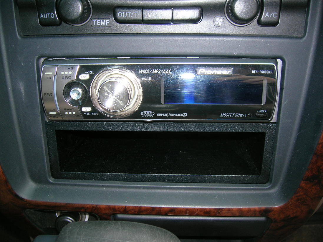

This is my audio setup. No competition setup here, but it actually does really well. Head unit is a little beat up, but it's been a good one for about 3 years now. I have the ipod adapter that allows control from the HU.

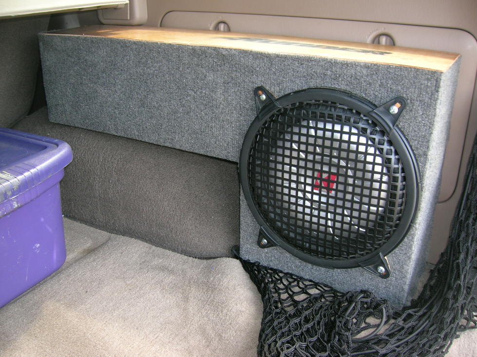

This is my custom box. It is a 10" Kicker CVT that I had bought to go under the back seat in my old Chevy. It's shallow mount so it worked really well here also. It's a 2 ohm single coil setup. Many people are surprised when I tell them it's just one 10". I will never buy another sub except for Kicker. It has been the best and I've been through quite a few.

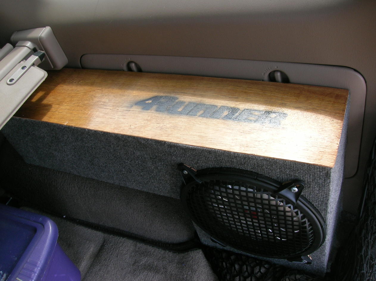

A little customization to match the woodgrain elsewhere. The box fits great and with the grill cover it keeps the storage space really usable.

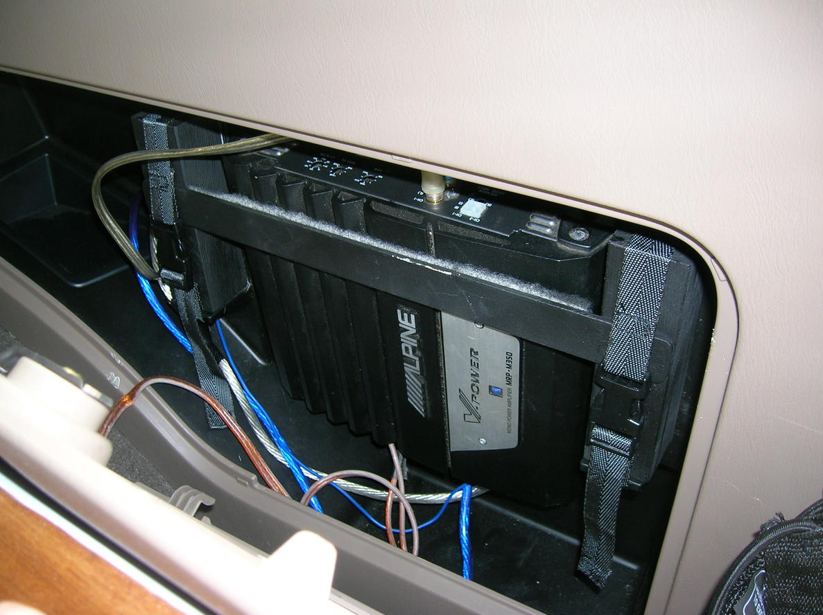

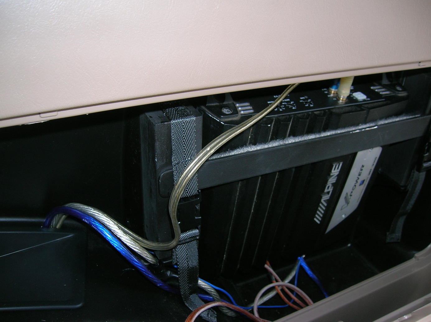

My amp fit like a glove in the storage compartment. I used the straps and a bar to keep it in place so I didn't have to permanently mount it. It's a class D so the tight quarters isn't as issue. It's wired for 2 ohms 350 watts rms to the sub.

limited 2k - Nice I like it, thats all i would need. I also like how well you hid the AMP looks like a great spot. Any overheating issues with it in there?
Nope, no overheating issues whatsoever. It helps that it's a class D mono block amp so it puts off less heat.
