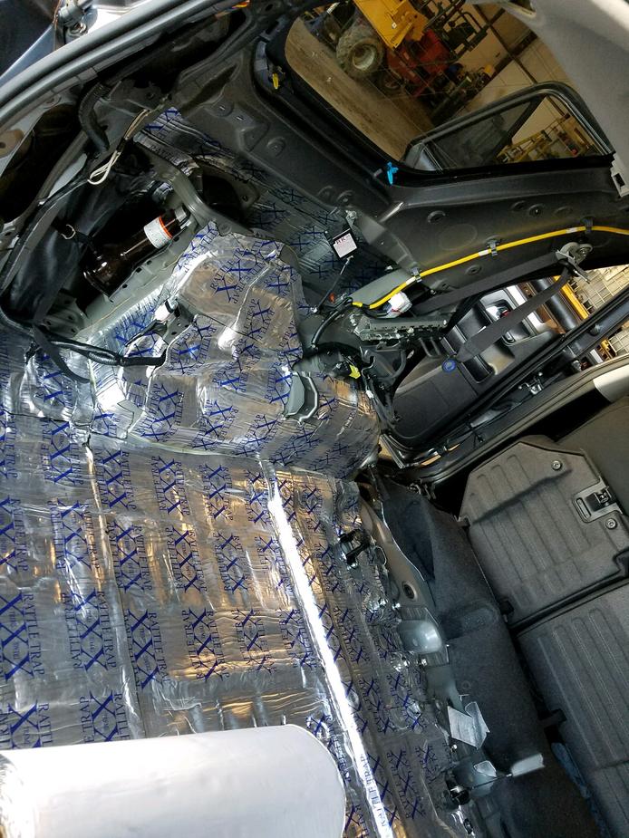

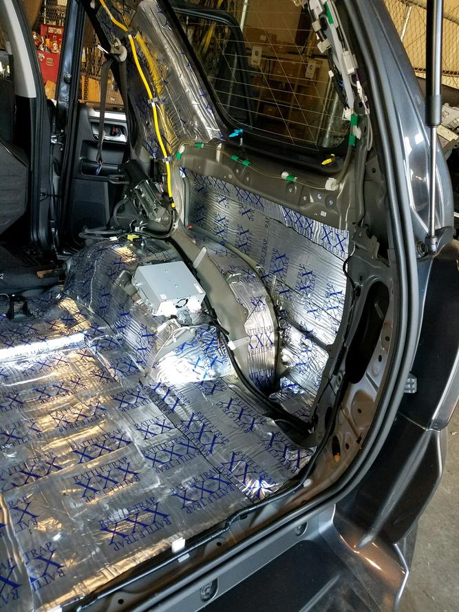

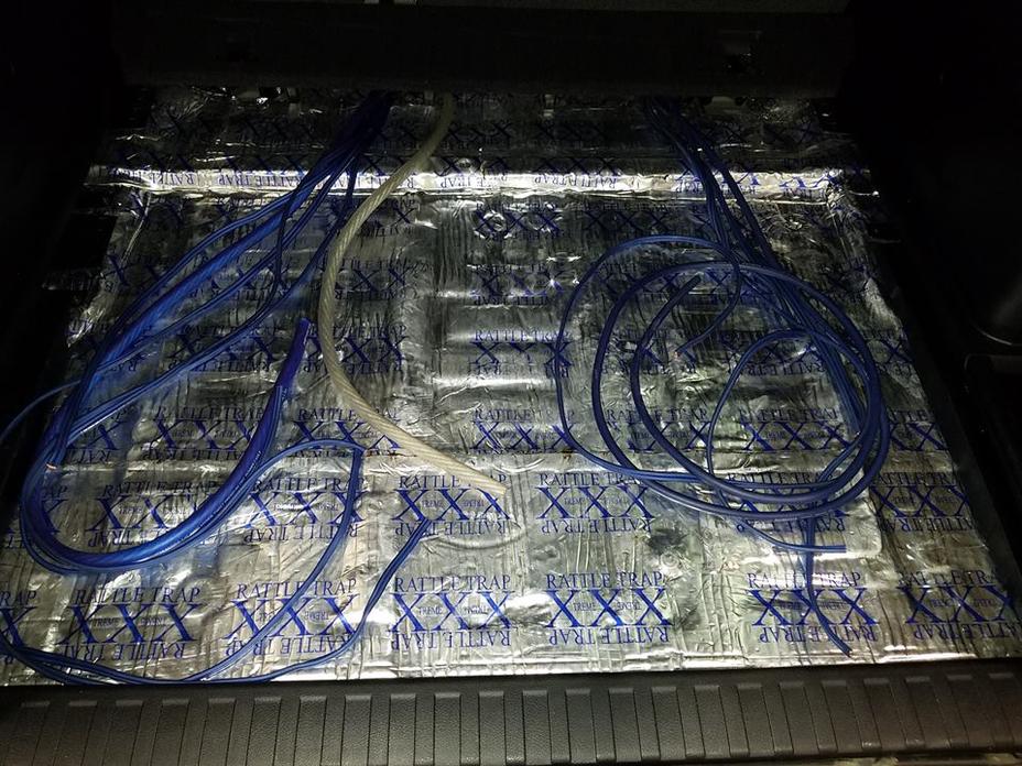

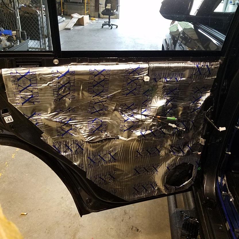

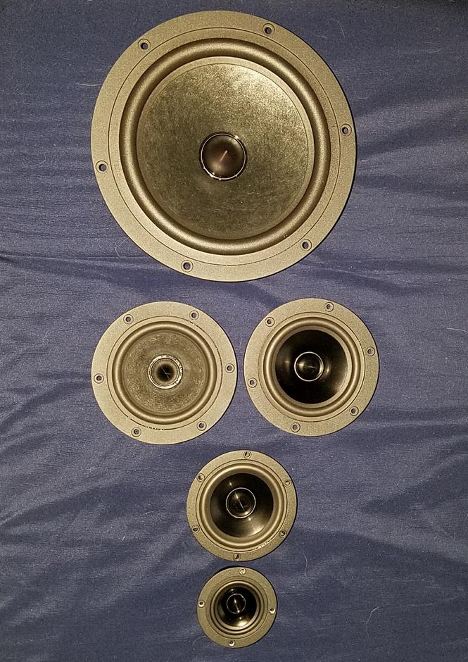

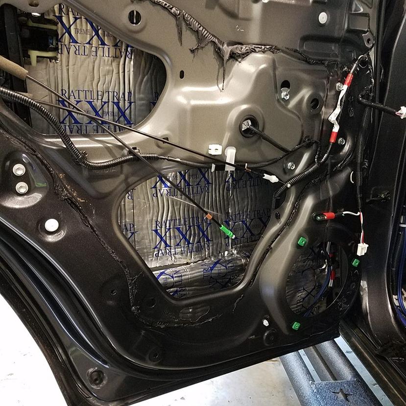

5 channel amp, replacement speakers, small sub. How deep your pockets are and how far you want to get into it will determine what speakers, amp, sub, you go with. For now I have JBL GTO speakers everywhere. 3.5 in the dash, 6x9 in the front doors, 6.5 in the tailgate and rear doors. I'm currently building my system a piece at a time and will do a full install when I have it all which is going to be pretty insane. Here's what will be on each side up front once finished. 8 in the doors, paid of 5s in each kick panel, 3 in the dash, 2 in the A pillars. I've also done quite a bit of sound deadening.
