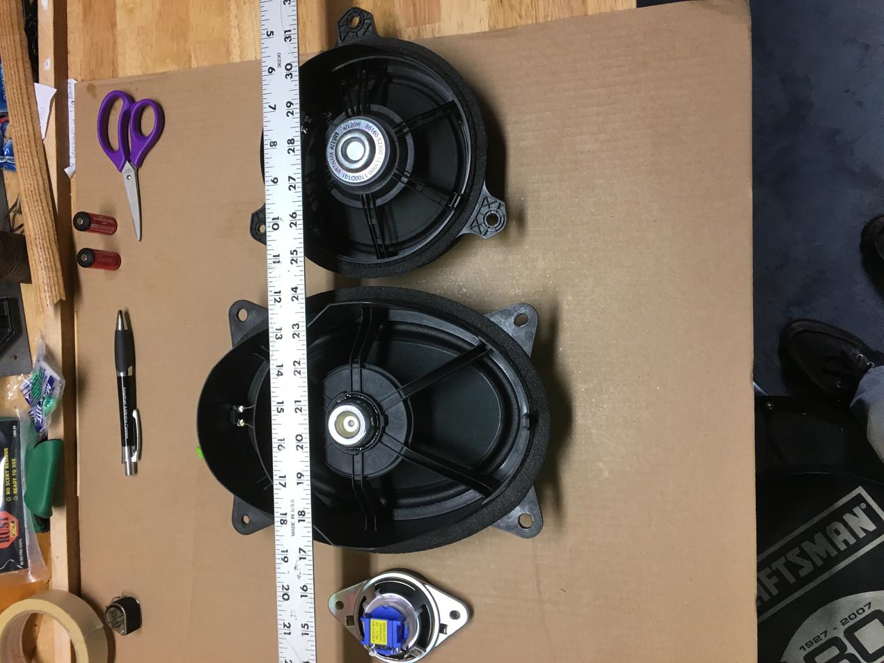

Dash, front & rear door speakers taken from my 2016 Trail Premium...
