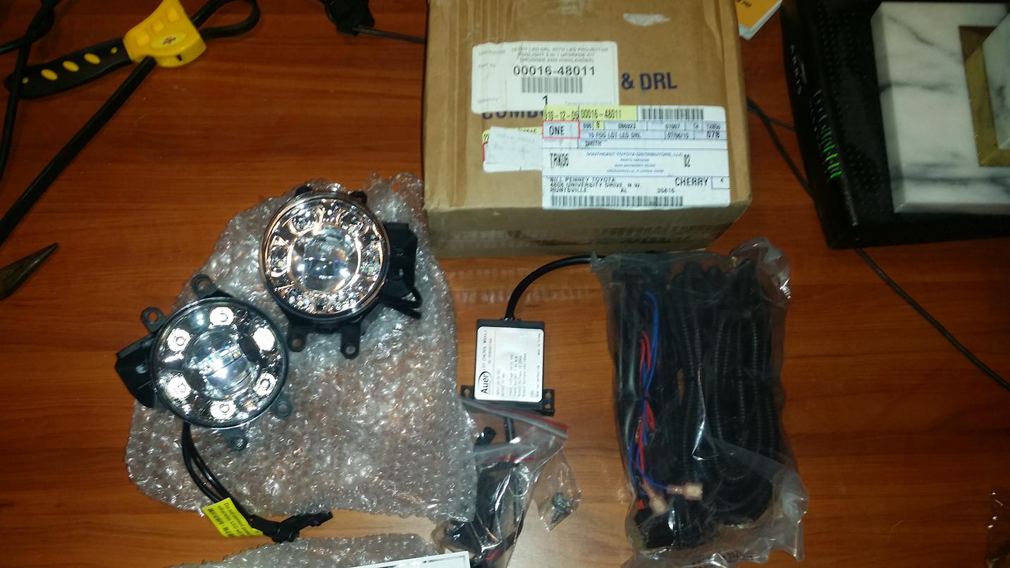

Purchased brand new from the dealership originally to go into my 2016 limited.

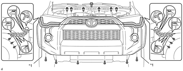

However on the 2016 limited the shield (see video 2:19) that piece is now molded into the front bumper so to install these in a 2016 limited you would need to either cut that "cover off" or remove the whole front bumper and modify accordingly.
Toyota 4Runner 2 In 1 LED Upgrade Kit - LED Daytime Running Lights W/ Integrated LED Fog Lights

I am considering getting in there and cutting of that "splash guard" with a hot razor blade...vs removing the whole front bumper to get in there.

Going to take off the front bumper if its not raining tomorrow and get the installed.

had to take the bumper off twice...

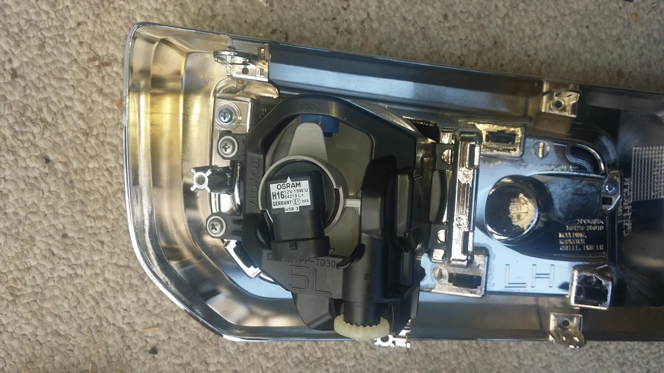

first picture is the back of the 2016 limited fog light housing self explanatory

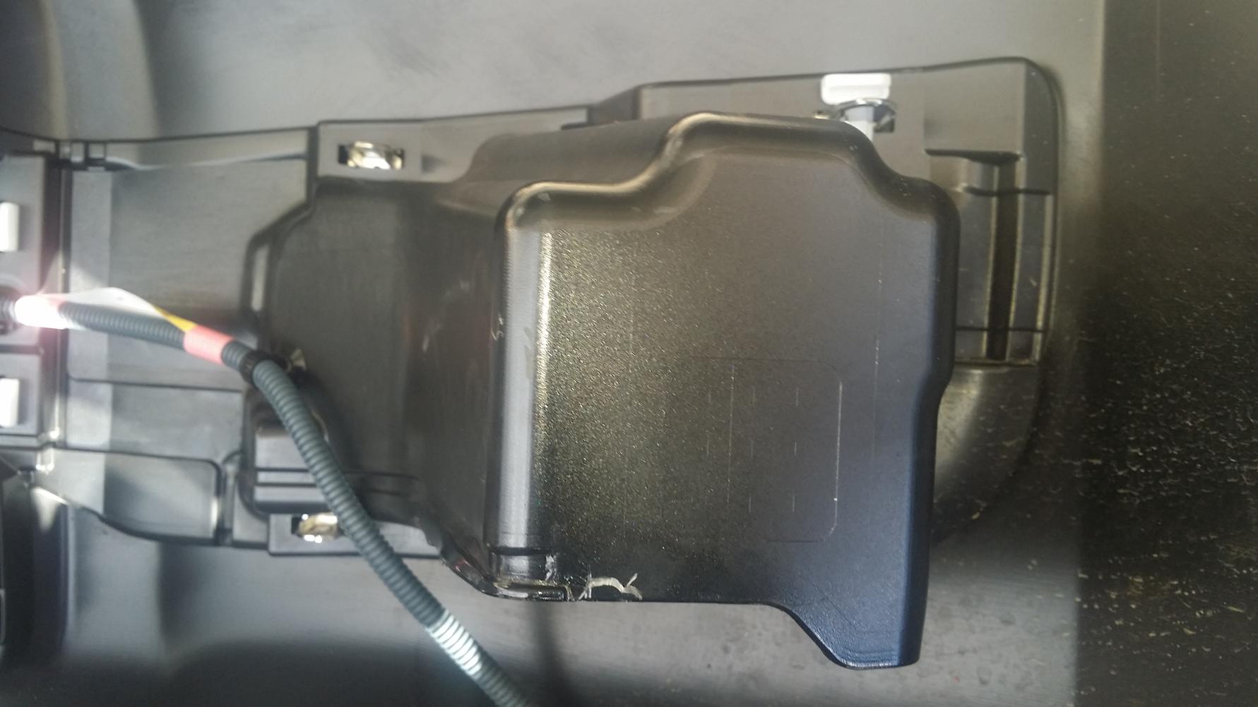

second picture is the MOLDED IN SHROUD :frusty: that makes you remove the 16 limited bumper to install these led DRLs

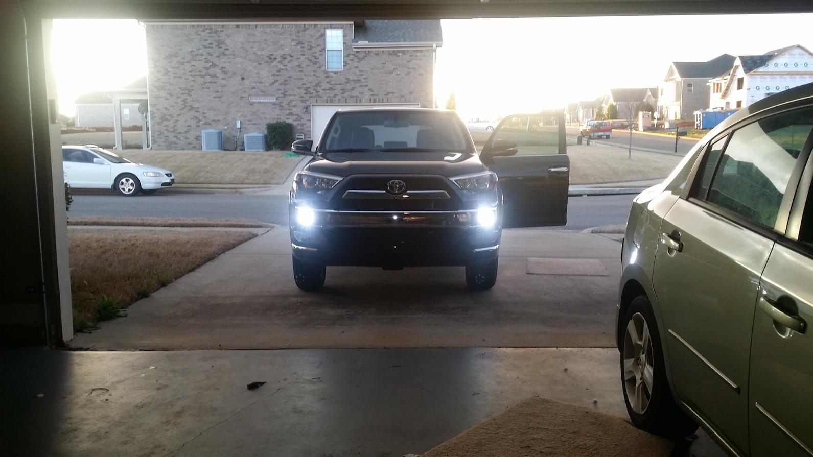

3rd picture is just the DRLS

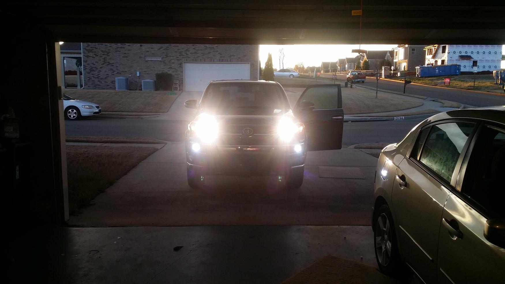

4th picture is DRLs ( yes they stay on) with fogs and low beams on

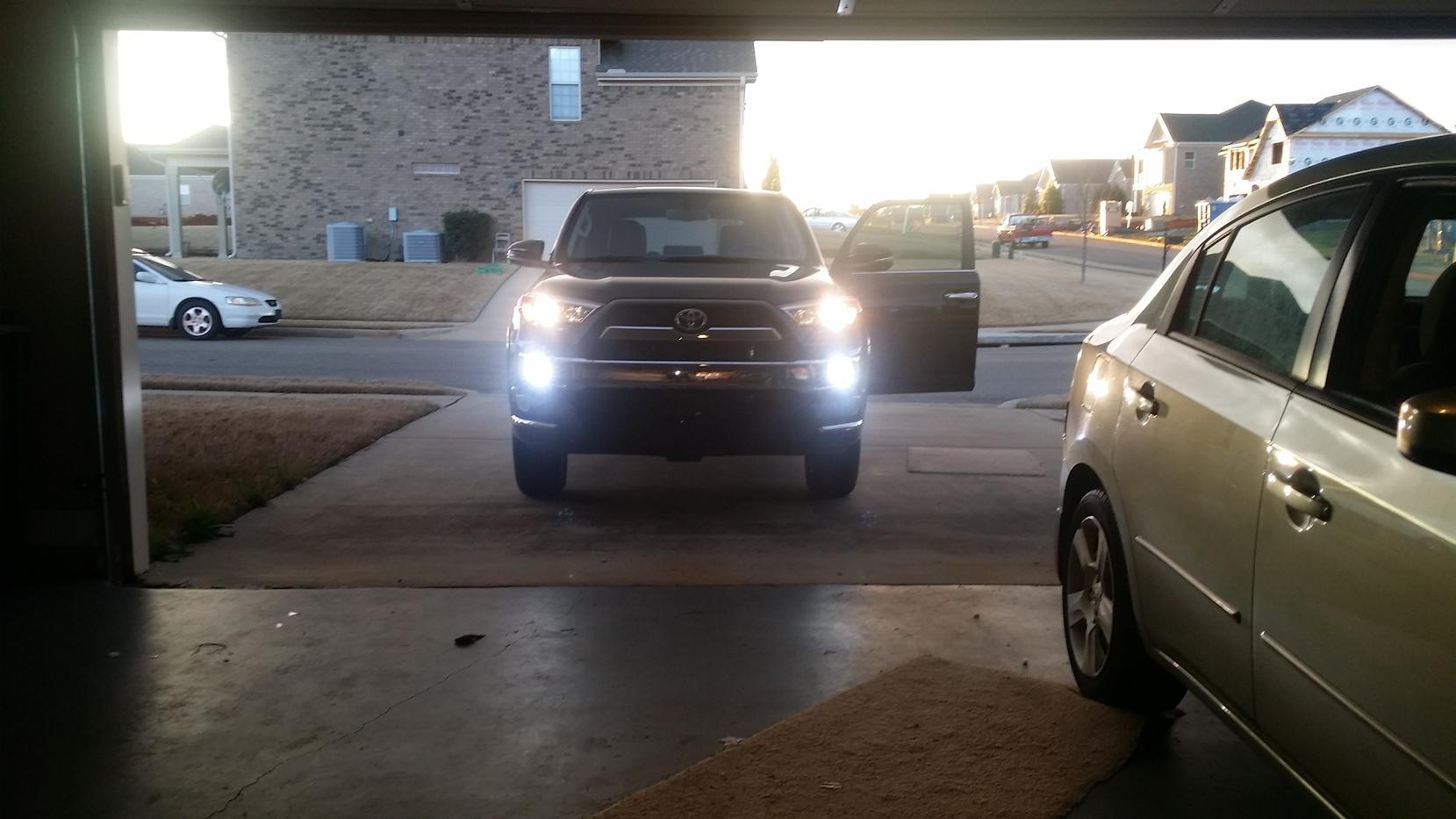

5th id hi +low + just DRLs ( did not do the fogs always on mod) will do that later

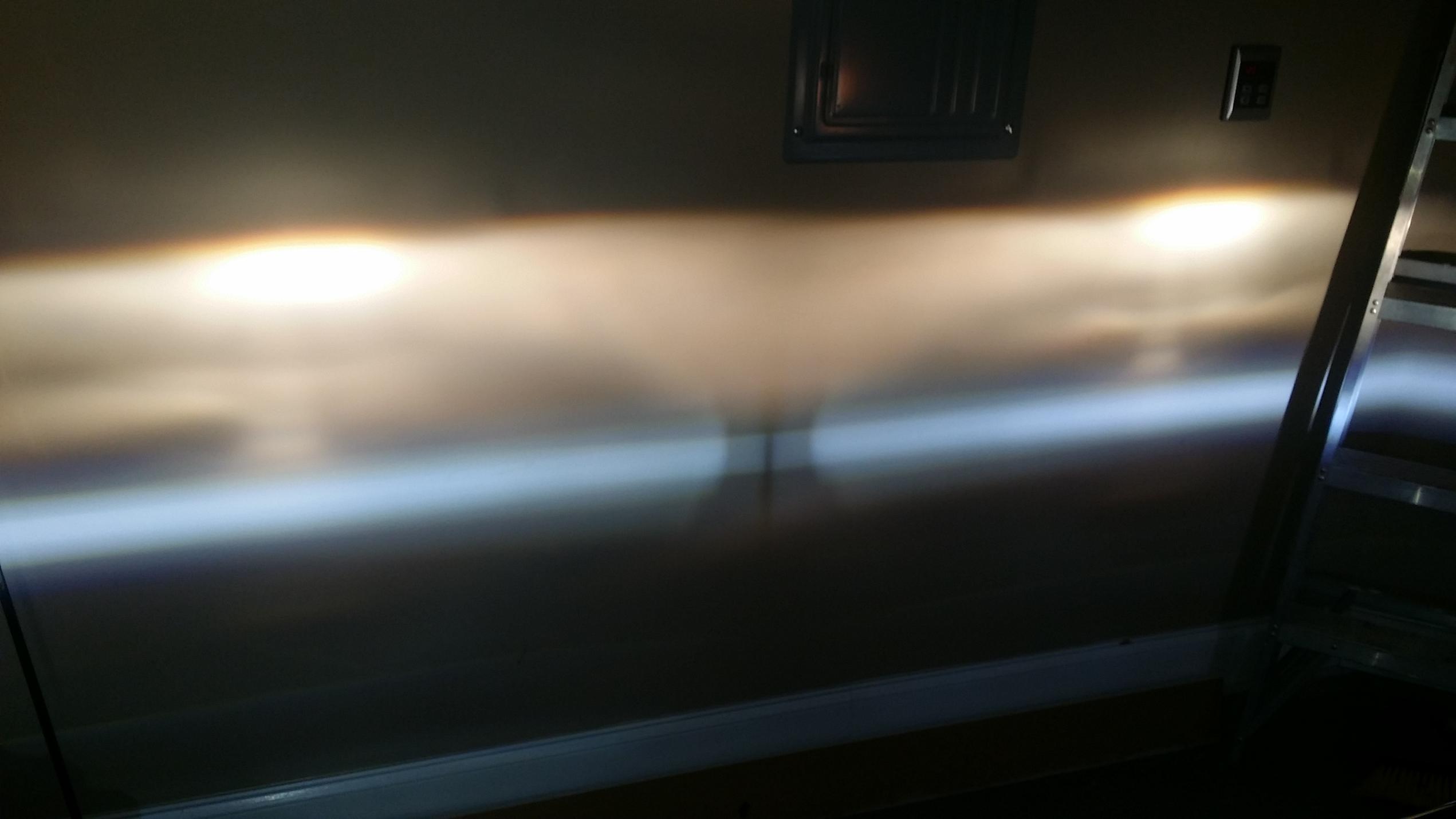

6thi is the cut off pattern set at the same cut off height as the factory fogs were
