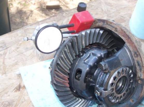

Measured gear lash in several spots on ring gear using a dial caliper and magnetic base
0.0011 noted in all locations

Measured gear lash post install, same 0.0011 noted in several locations
Torqued bearing caps and measured lash again, same 0.0011

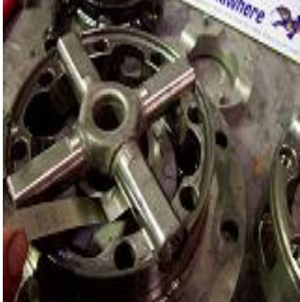

The clearance, or gap, between the cam gears is critical to the operation and manners of the locker. The tighter the gap the more prone it is to locking and staying locked; not great for a mostly-street driven vehicle.

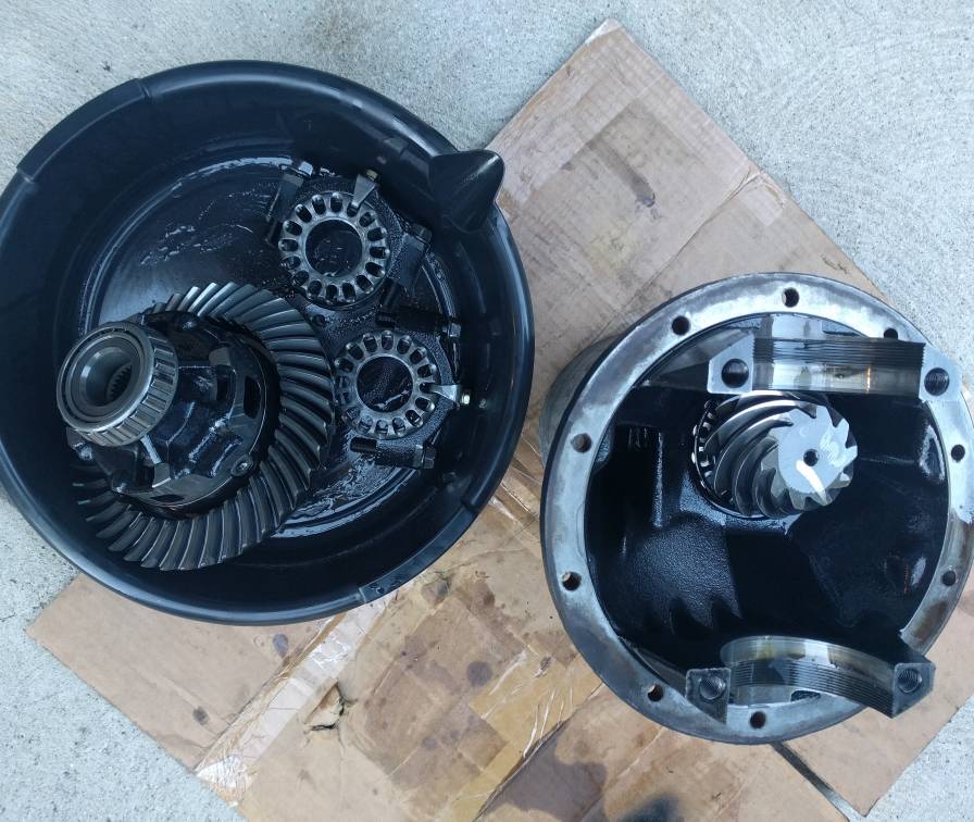

Picking up where this post left off, I repeated the disassembly of my rear axle and pulled the third member again today. It gets easier each time you do it, really.
Dropped my new thrust washers behind the axle gears and measured for tolerance - 0.154" BINGO! Now the next measurement was the spacer ring to the cross shaft that the spider gears used to ride on. The tolerance there is supposed to be within 0.006"-0.020" and with my new 0.030" thrust washers I had a comfortable 0.015" measurement here - cousin, we in business!

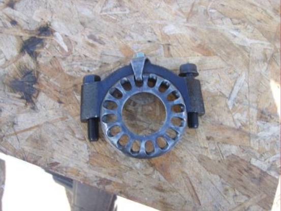

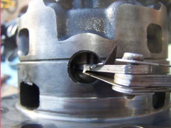

Measuring cross pin to spacer clearance, photo courtesy of Aussie Locker Toyota V6 instructions

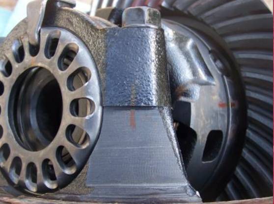

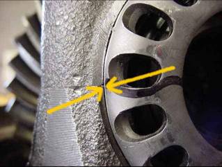

Now, here is the secret sauce, the place where I deviated ever so slightly from the Aussie's instructions - I DID NOT REMOVE THE RING GEAR FROM THE CARRIER. After reading Toyota's instruction (boil the ring gear before install) and having to get those ring-gear bolt retainers, I found another way to measure the center clearance rather than using feelers - I used allen wrenches.
This is how I did not do it, lol, photo courtesy of Aussie Locker Toyota V6 instructions
Yup, between my buddy and I we had about 200 loose allen wrenches we had accumulated over the years, so I mic'd em till I found 4 (not 2 like aussie says) 0.153 and 0.155 allen wrenches. to use in lieu of feelers. I inserted the allen keys into the carrier, in line with the teeth of the ring gear, through the side holes in the carrier and into that center gap between the cam gears. I got 4 of the 0.153" wrenches in but could only get 2 of the 0.155" wrenches in the gap (180° opposite each other) and not very far - so I called it good at 0.154" and proceeded to assemble the carrier.

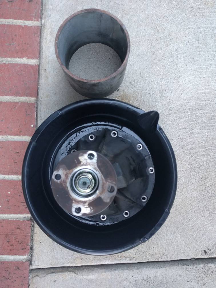

I lubed the snot out of all the internals with gear oil and reassembled the carrier. Torqued the bolts, thanks to [MENTION=71326]Buckaroo[/MENTION] for the torque spec sheet, and my buddy with a huge channellock wrench to hold the carrier while I torqued the 8 bolts to spec.
Then we lowered the carrier into the 3rd-member housing with the bearing cap and adjust assemblies still together but I didn't trust 2 halves of a threaded assembly to go together perfectly on 2 opposing sides with the pressure of the bearings pushing outwards against the races - so again I deviated from the instructions; kinda how Zuk shows it done.
Bearing cap and adjuster assembly left assembled, photo courtesy of Aussie Locker Toyota V6 instructions
I had marked both bearing caps and noted the step between upper half and lower half - barely enough to get a chisel on to separate the two halves when we disassembled it. So I installed the pinion side (the lighter side of the carrier) bearing cap, race and adjuster as a unit with the carrier into the 3rd member by lowering it in while my buddy watched the threads of the adjuster align into the threads in the housing - hard to visualize until you do it. Once we were sure that side was not cross threaded, we tightened the cap screws down hand tight and focused on the ring gear side.
Example of marked cap and and base, I used a punch, photo courtesy of Aussie Locker Toyota V6 instructions
Similar to Zuk, we had marked where the adjuster cap aligned with one of the splits (bearing cap to bearing base) and we disassembled that cap and adjuster.
Adjuster cap marked at cap/base split, picture courtesy of ZUK
Lifting up on the ring gear side of the carrier but keeping pressure towards the pinion side race, we were able to get the ring gear race into the carrier base past the threads and fit the cap. We matched the gap and threads on both sides (left and right, or top and bottom) and tightened the cap screws hand tight. We had to tap the race in towards the bearing a few times as it is coned and the weight of the carrier bearing against the race pushes it outward, away from the bearing - it was quite the balancing act and there was no way someone is going to do this alone with out lots of experience or special tooling.
Once we were sure the threads in the bearing cap and base were aligned, I started spinning the adjuster COUNTERCLOCKWISE until I felt it jumping it's lands, this way you won't crossthread it. Turning clockwise until it was mostly in we progressively tightened the bearing cap screws to get the correct preload on the adjuster until we got our mark aligned with the split, and then some. At this point we tightened both caps to 35 foot pounds (what the torque wrench was set to from doing the 8 carrier LH bolts) and measured the ring gear to pinion lash with a dial caliper on a magnetic base. Working the ring gear a full 360° we too 4 measurements that all equalled 0.011" of lash - this is the same measurement we noted both before we disassembled the first time and when we put it back together the first time - so it had to be good, right?
Measuring gear lash, photo courtesy of Aussie Locker Toyota V6 instructions
Torqued the bearing caps to 63 foot pounds while my buddy held the 3rd member from spinning with those big channellocks from the last chapter and then torqued the adjuster lock screw to 9 foot pounds. Just to be crafty, we actually positioned the adjuster lock against the adjuster ring with no slack on the right side, the counterclockwise side, so there was no possibility that the adjuster would slip over time and allow the lash (0.011") to become greater. Now I was ready to muscle the 3rd member back into the rear end housing.

Third member major components disassembled
Third member housing and pinion with a section of big-ass pipe we used to stand the third member up in in lieu of a coffee can
