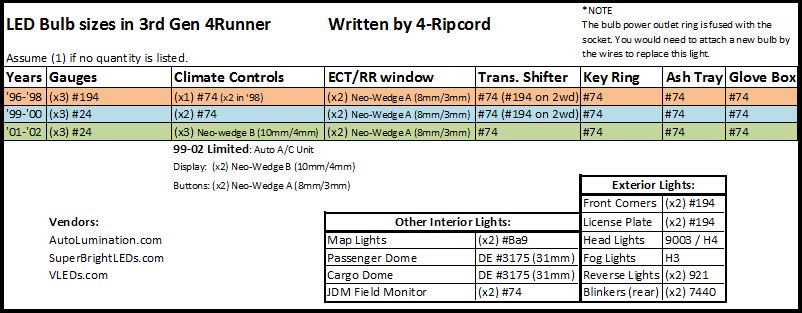

The chart image (first image) is no longer available there. I think that had the info you want.
This?
Did this a while back. Only my fan knob lit up and a corner of the screen. Just get the bulbs from the dealer, they aren't that expensive. Unless you really want some new colored bulb to go with some color scheme your doing inside the vehicle. Just tell em you want to replace every bulb in the climate control unit. It's 4 total. And you'll want to change them all...I changed just the 2 that were out and they sucked up the power and made it look like the 2 that were working were dead...So I replaced all 4 and now everything is lit up again.
