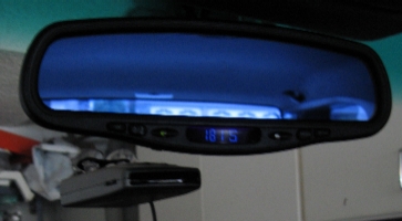

The picture below shows what the blue tint looks like

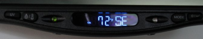

close up of combined temperature and compass alpha only

Ran the mirror late last night and the auto-dim worked fine. It is funny that the blue tint makes it look as if everyone is running HIDs.
