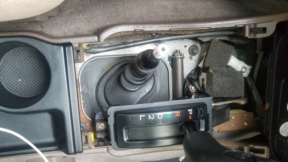

I'll wing it with a answer since you didn't give much info and it's happened to me in the past. Have you ever replaced the bushings for the shift lever? When Trans is in drive can you wiggle the lever around, left to right, forward and back. When the bushings are worn out and broken it can cause what you describe.

you say slipped from drive to neutral? if you mean it just popped out of gear into neutral, that's much less of a concern than slipping in drive. i had a 4runner a while back that would do that. bad transmission mounts/bushings caused a lot of slop in the drivetrain and on big bumps it would bump into neutral occasionally. not a big deal, just needed trans mounts.
I would check the shifter bushings. Mine slipped and when I checked it was only blue dust left over. Swapped them for 9 bucks and it's brand new! If you look and see that crossbar right above the 4x4 you will see the bolt with blue dust. There's two on top and two on bottom.
