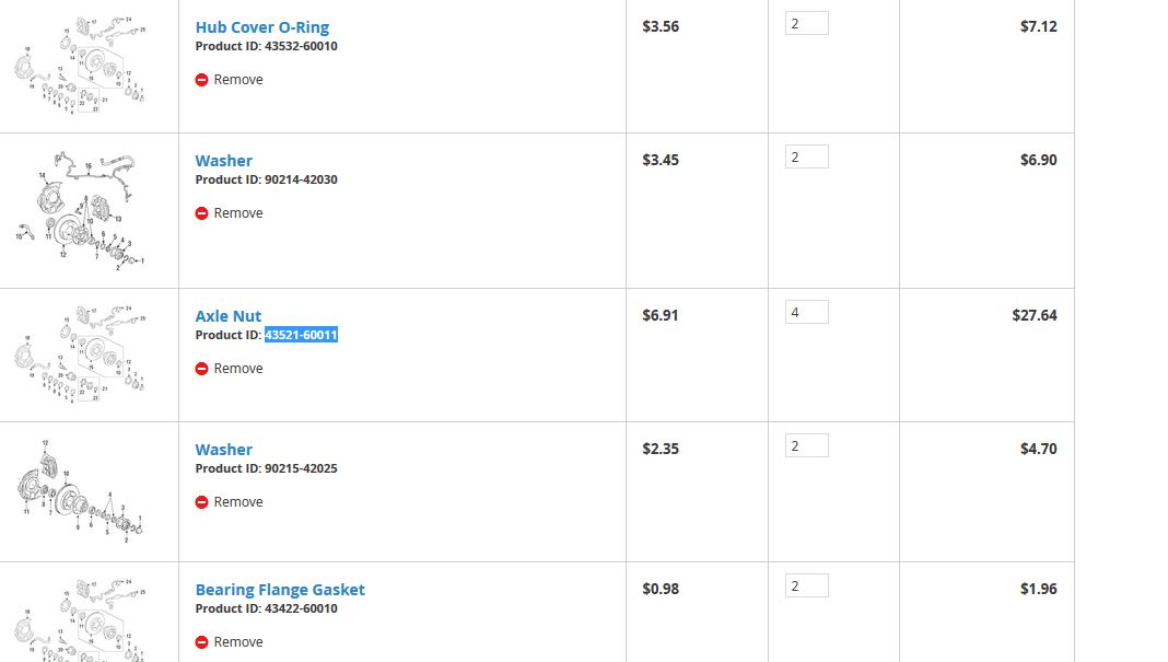

So im in the middle of my swap. Just cleaned up and painted my hubs. I still need to buy all the parts. Im curious if anyone has heard of “Karsons” they make a bunch of Toyota parts and i found a hub “kit” with all the axle hubs and washers much cheaper than OEM.
Anyone know if they are good?
Here is also the parts list with part numbers in case anyone needs it and best pricing I have found. Only thing not in the attachment is the star dial gasket. The part number for that is 43531-60010

I have Aisin hubs, i'm rebuilding them. i was referring to the swap parts so like the two 54mm nuts, spider washer and flat tabbed washer. I linked the parts above.
Those parts should be fine.and some kits substitute a round gasket
but inner clearence needs to be verified.
