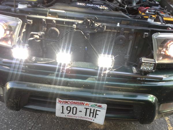

3. Get an LED lightbar from amazon. Mine will put a pair of PIAA's to shame.
Do this! :) if you want a write up let me know. It cost less than $20 to build and doesn't ugly leave holes where you can see them in the bupmer. :D And as far as lights mine are from ebay, but I know that is a sore subject....
