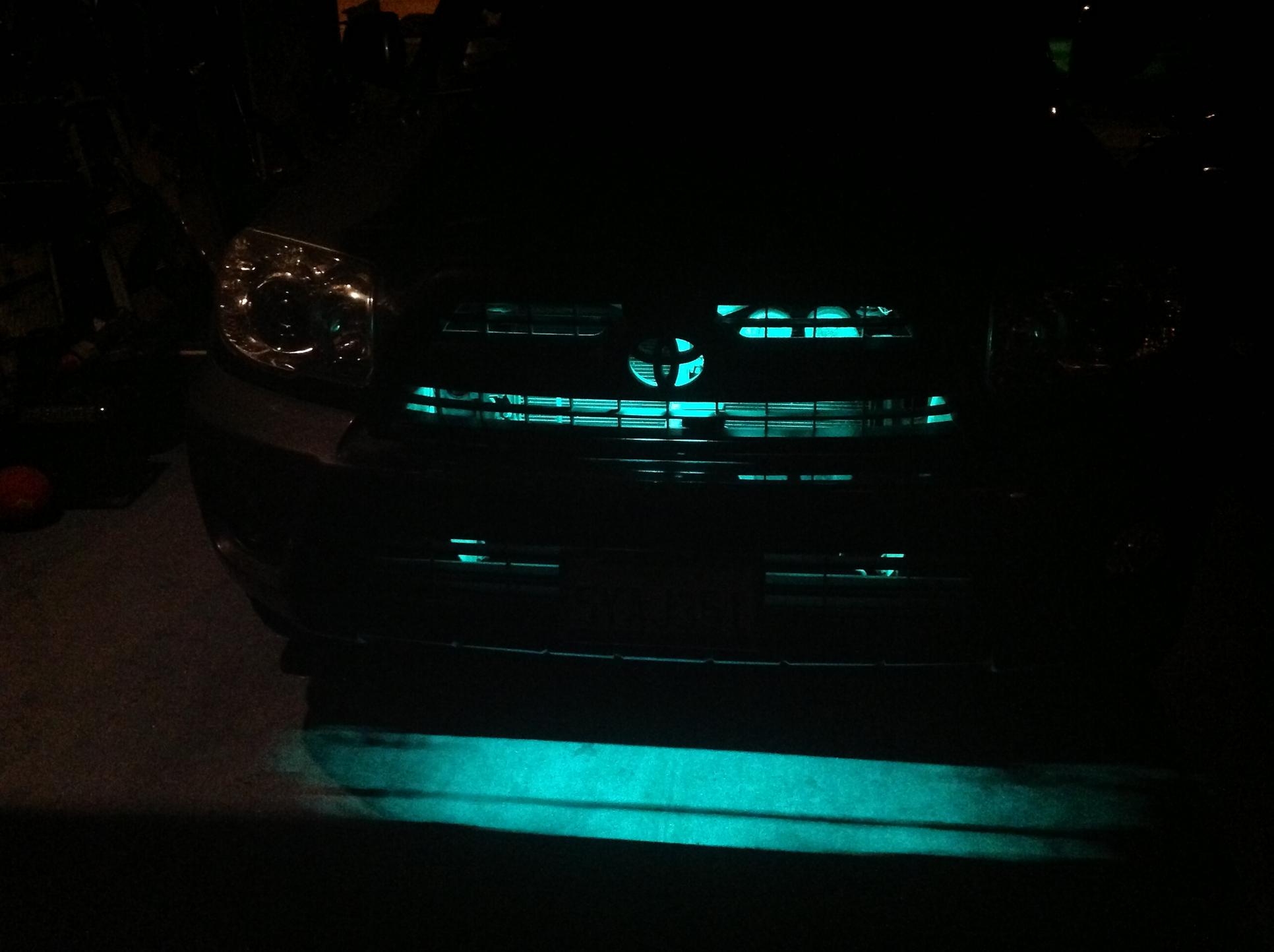

So interesting thing. When i was using a test LED i got the LED to dim in and out with the car locking and unlocking. That was the negative wire. Im not sure what changed, but after hours of not getting the strip to work and blowing the 10Amp fuse, I finally realized the wire in question was positive. So after wiring my LEDs to the positive and ground straight to the battery.
However it doesnt dim like its supposed to. It does however turn off about 5 seconds after locking the truck. Just straight off and on no dim. So for the moment I am satisifed. My
The color looks teal in the pic but rest assured its green. My only other bother is that now I can see my radiator parts lol. This just screems the need for a satoshi. Who wants to help???:D

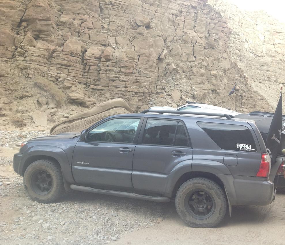

also attached another pic of the badboy in Ocatillo, Socal.
