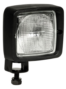

I am planning to install some aux reverse lights. These have the typical 12v/55watt lamps. The wires on the pigtail coming off the light fixtures are 16ga stranded I ~think~...
I plan to use the Hella diagram here...
http://4runners.org/image/hella500/hella_500_auxfusebox.jpg
I will likely mount the aux fuse box under the rear passenger seat, like robb1887 did. Seems like a good central location and out of the elements.
I need help with the wire sizes. I tried using a few online calcs but they came out different. I am sure some of you guys will know the answers.
What size wire from the battery to the fuse box?
What size wire to the aux reverse lights?
