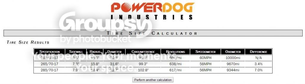

Its more around a 7% correction.
No, it's actually between 3% and 4% correction.
Obviously every tire in a given size may vary slightly per manufacturer, but a 265/65/R17 is a 30.6" tire and a 265/70/R17 is a 31.6" tire.
A 265/65/R17 will turn approximately 660.2 times per mile and a 265/70/R17 will turn approximately 638.4 times per mile.
638.4 / 660.2 = .9669 or 97% if you round up.

then every tire size calculator is wrong.

I'm not interested in who's right or wrong, but it's important to get the correct info out there. God knows there are so many threads with incorrect information and speculative opinions.

I'm not trying to start a fight here, but I've tried in two difference online calculators and both come up with ~3.40%. Which calculators were you referring to that show 7%? Are you perhaps including an extra few percent to correct the stock speedometer's inaccuracy?
265/65-R17 vs 265/70-R17 Tire Comparison - Tire Size Calculator
Tire Dimensions Made Simple - Discount Tire
Every tire (even the same overall size) may have a slightly different overall diameter (due to tread differences)... so the only way to truly calculate your individual error is to divide the diameter of your new tire by the new stock tire diameter (whatever that was for your vehicle from the factory)...(this will generally give you 1.0335 or something... (and this is the number you multiply by the trip odometer to get your actual miles driven as previously stated to calculate your true mpg after a tire size change)
That being said... going up to 265/70-17 from the stock size of 265/65-17 generally gives around 3-4% error (tread depth varies, but not by enough to let the error creep outside these bounds for these overall sizes).... If you're using 7% error for these tires sizes then something else is going on outside of the tires to give you this error... numbers/math do not lie.
