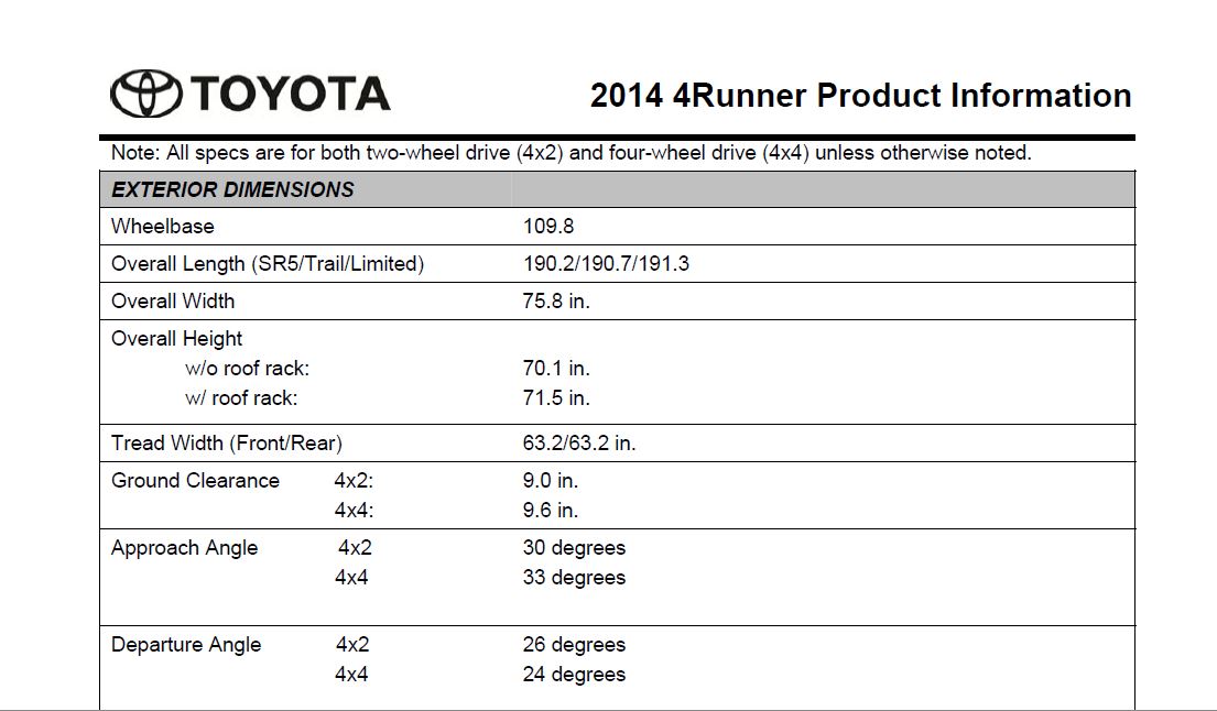

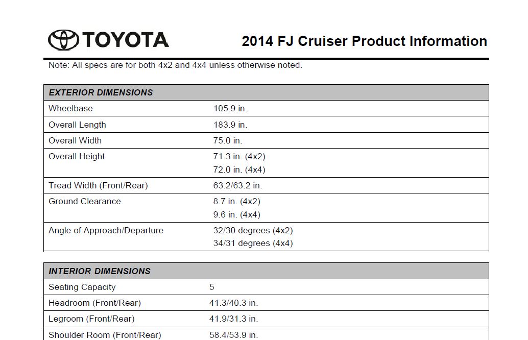

The axles are the same width. The platform of the frames are the same, but they are also different in many ways. You can't use skid plate measurements as a comparing tool between the 2 vehicles.
