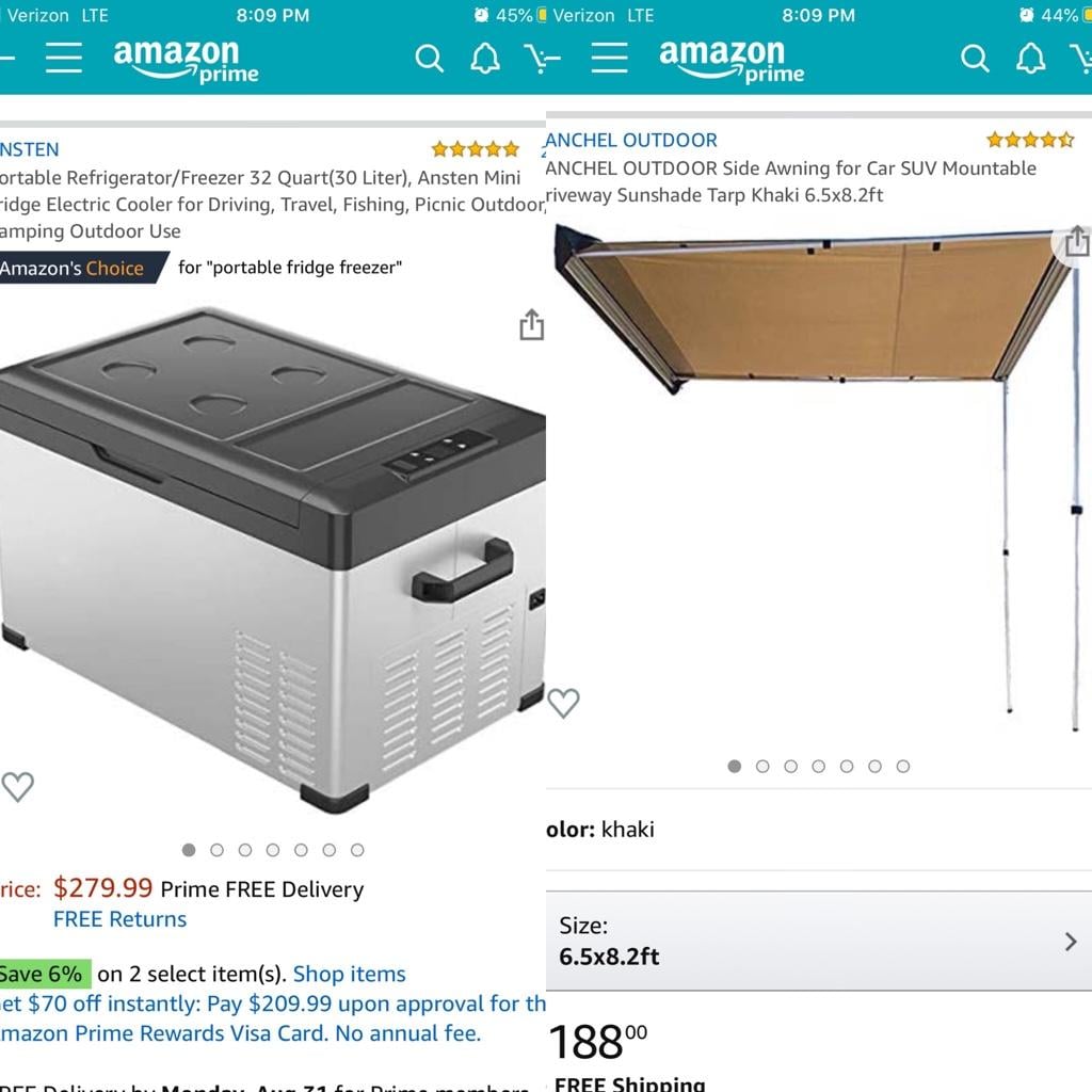

Pulled the trigger on these two looooong overdue equipment upgrades [emoji1360]. Not top of the line but should meet my needs versus none at all. Under $525 in stock arriving next week in time for the HOT [emoji3508] AZ Dove hunting season. #shade_coldbeer
Any tips on mounting the awning to stock roof rails. Also, lessons learn with a AC fridge on a homemade wood riser (no drawers at this time)

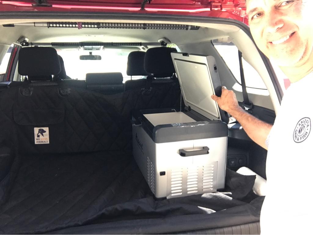

I got the Alpicool C30. Here's a link.
Reasoning - fit my budget < $300, availability, size - just about perfect for my rig and needs, lid opens on the long edge, not the short edge - so I can open in Runner without needing slides, good reviews, good ratings, AC and DC powercords, quite, 3 stage battery protection, decent tie down handles. Oh, and to my surprise when it arrived - Bluetooth controlled!
Only had it 2 days, and tested at 30* in car in 109* AZ temps. Does well when on power, but my tests were empty cooler (well 2 beers) and when not running it heated up about 10* = so still a cold beer after a hour hike.
I'll be interested how long it stays cold with a full load. Any case, I'm in love. I've always wanted one, and I'm already impressed and excited to have one.
