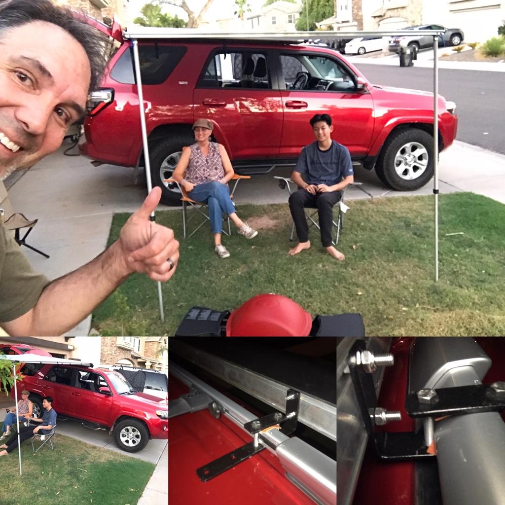

So the hardware with the awning installed fairly straight forward on the stick roof rails. Not super clean (excess brackets) and one nice paint gouge but it’s secure and solid. Fits my needs perfectly.

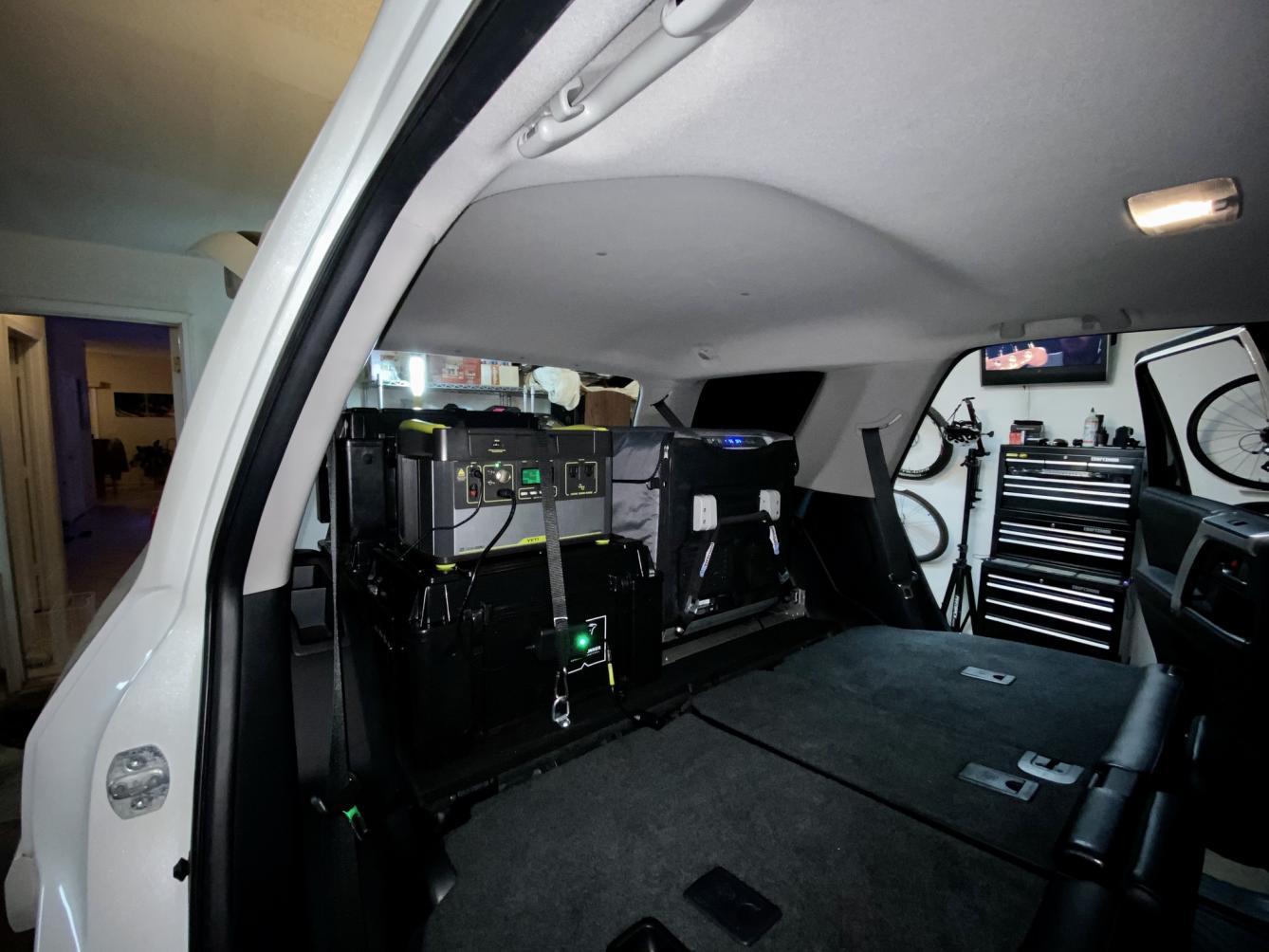

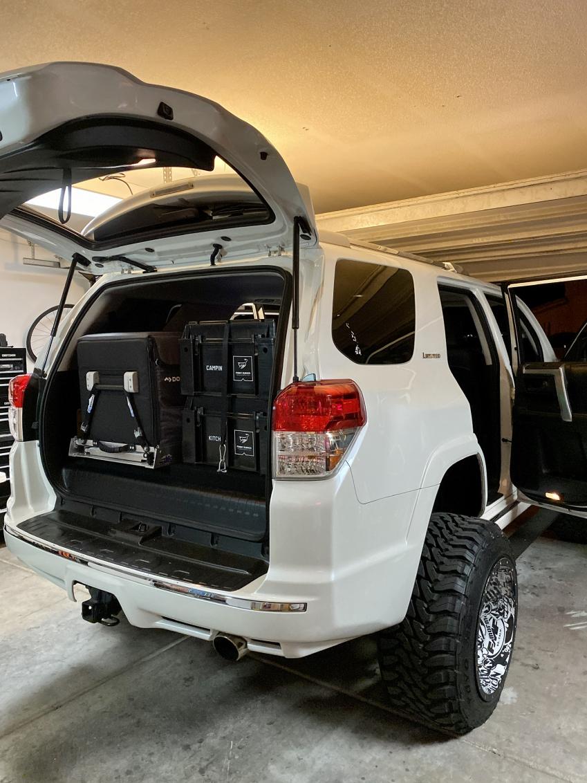

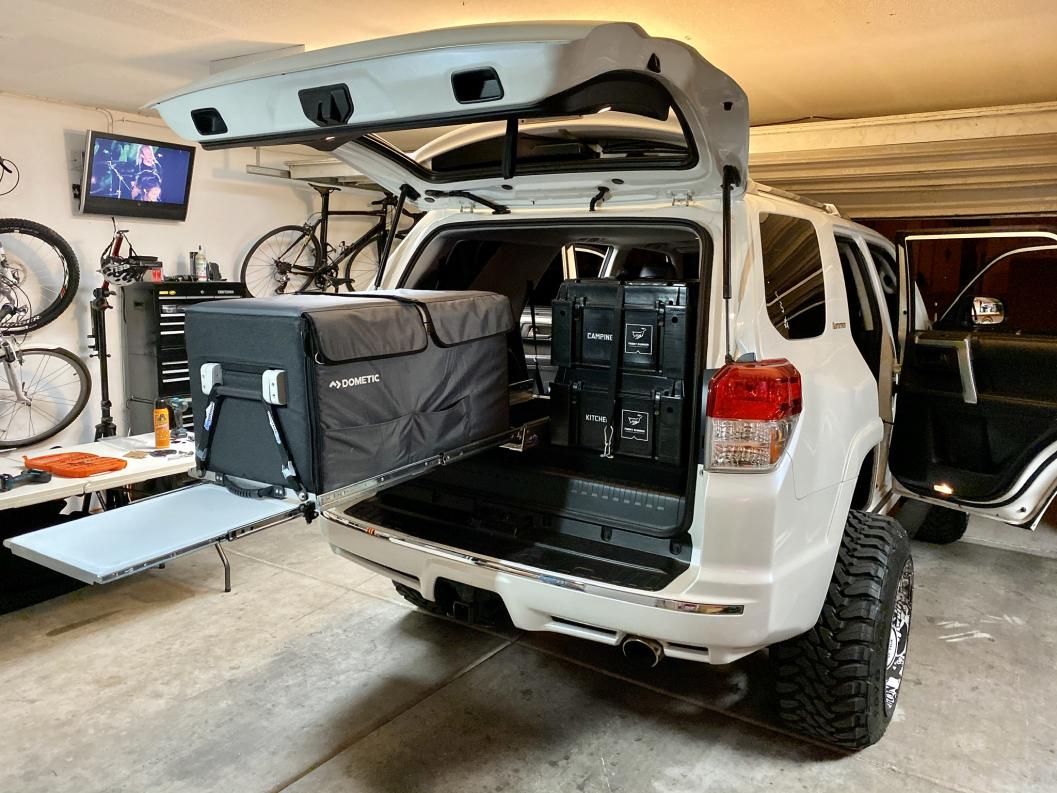

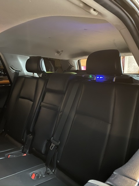

Dometic CFX75DZ w/Goal Zero Yeti1000
My system is run very similar Yeti powers the Dometic and recharges from the main battery. If I’m out for several days camping I plug in solar panels to keep the Yeti charged.

Oh wow, that's another league completely. Look at that killer setup! Double slide extender. Very nice. Sweet Garage too. Kudos.
I watched some videos on running a hot line from the engine compartment to the back of the cargo area, that power unit is starting to sound a whole lot better. What a job. I'd break every panel clip and never get my interior back together the same again. I might op for conduit under the body! LOL
