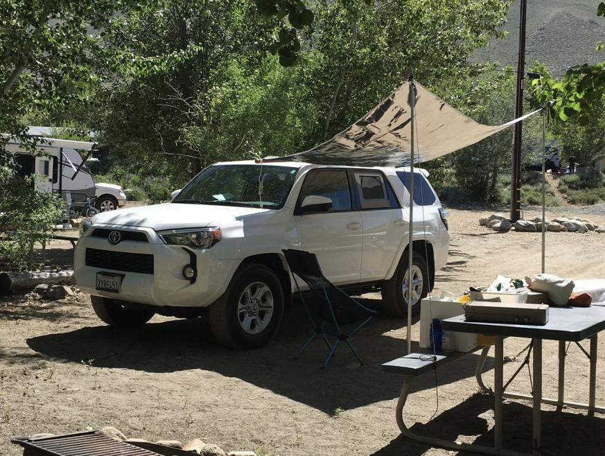

You did not say you aleady had an awning.
I DIY my awning because it is stored in garage most of year. I also highway travel with it in cabin to avoid wind noise.
I use a super reflective tarp (forestry supply) 6' x 9' ' that is white one side and silver other side.
Easy to set up and tiny in garage. A 6' solid bamboo type pole inserts into PVC pipe. Home made brackets and hose clamps hold PVC to stock rack.
Twist lock painters aluminum poles and nylon lines keep awning up. Works both sides of my SR5. Sets up fast.
