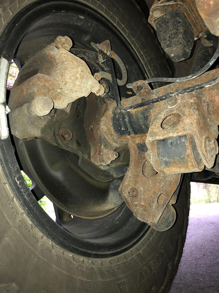

I was confirming the casting numbers on my calipers and noticed grease on the backside of the driver's rear tire (see pic).
Bad axle bearing? I had the passenger side replaced about a year ago, so it wouldn't shock me. Assuming that's what it is, I'm guessing this is something I need to address before this upcoming brake job? Is this a good DIY candidate assuming I take it to NAPA (or somewhere) to have the bearing pressed out/in?
Was planning on replacing the rotors on all four corners (going with Centric) along with Toyota pads in the next few weeks (first brake job I've attempted). Am also anticipating on having to replace at least the front calipers with Toyota remans, as the current ones look awful but the rears look pretty gnarly as well.
Thoughts? Thanks in advance!

If all you're doing is removing the axle and taking it somewhere to have someone else do the press work then it's really easy. The hardest part will be getting the drum brake back together.

Yeah from what I've seen online, it's $50ish to have NAPA do it with supplied parts. Is it for sure the axle bearing, though?

Nothing is for certain. It could be the axle seal or even brake fluid.
If you have the bearing replaced, I'd definitely do the seal at the same time.

I tried just replacing the seal on mine, but it had formed a tiny ridge on the seal surface which allowed it to leak again.
My shop did press the bearing and seal part out but put a new bearing as well for a total of $175ish. I think I got the high-quality bearing when they offered it.
It is a fun job, not too hard, just take your time.

So, are you saying that when you redid it, you did the bearing as well the second time? Did you polish the ridge off too?
First time I did it, I just put a new $13 seal and JB weld on the metal surface. It worked for about a month then didn't.
Second time, I brought the axle to the shop. They replaced both the bearing and seal surface since they had it all apart.
Thanks for explaining further. That makes sense now.
