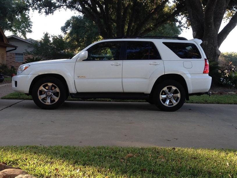

I found this one in Austin about 2 months ago. One-owner, dealer maintained, 78K miles for $20K out the door. This is a couple of days after I bought it (and my 3rd gen in the front)

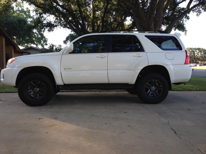

First thing I had to do was lift it. I couldn't stand the rake (close to 3" in stock form) and I hate having the same vehicle as everyone else. I want to make it mine. I chose a combo of the FJ 4x4 springs, the Daystar 1.25" topout spacer in the front, Daystar 1.5" spacer for the rear and Bilstein 5100 shocks. I set the front on the lowest clip thinking I could go up if needed. But I saw a few pictures with this set up and thought I'd like it. I also replaced the stock wheels/tires with some Tundra split-spokes powdercoated graphite and 265/70/17 Cooper Discoverer AT3s that I had on the 3rd gen. Measurements are below (from the ground to the wheel well)
Before / After:
front driver - 32.25" / 36.875"
front passenger - 32.25" / 36.875"
rear driver - 35.125" / 38"
rear passenger - 35.25" / 38.125"

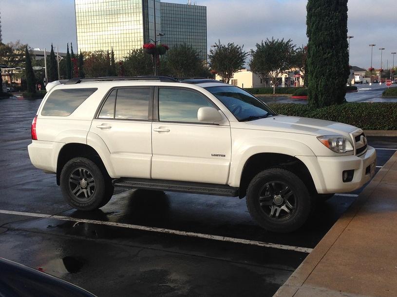

I finished everything at night so this is a pic from the next morning. With 4.5" of lift in the front, I was afraid I would need new UCAs, but the alignment came back with all numbers within spec, and there's no pull that I can notice.

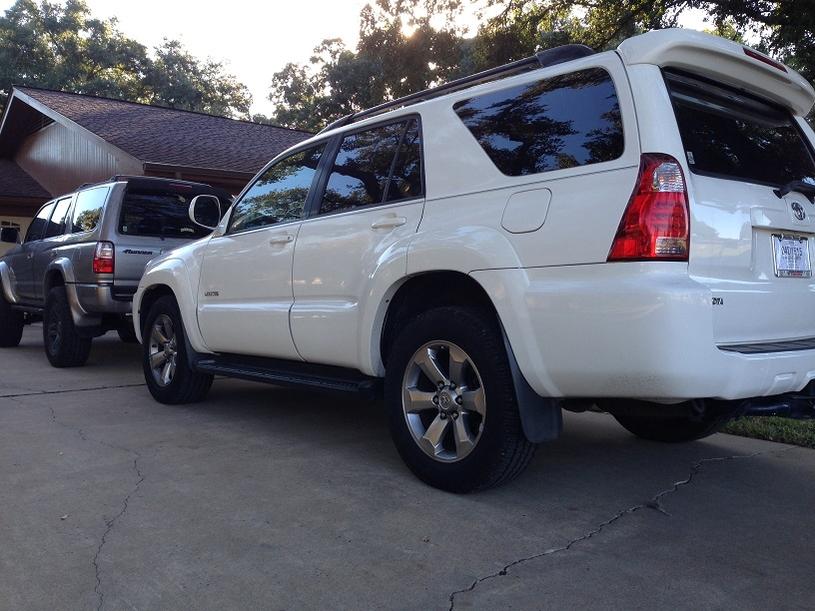

And the truck is pretty dirty in this pic, but I like how the light let's you see tires a little better.

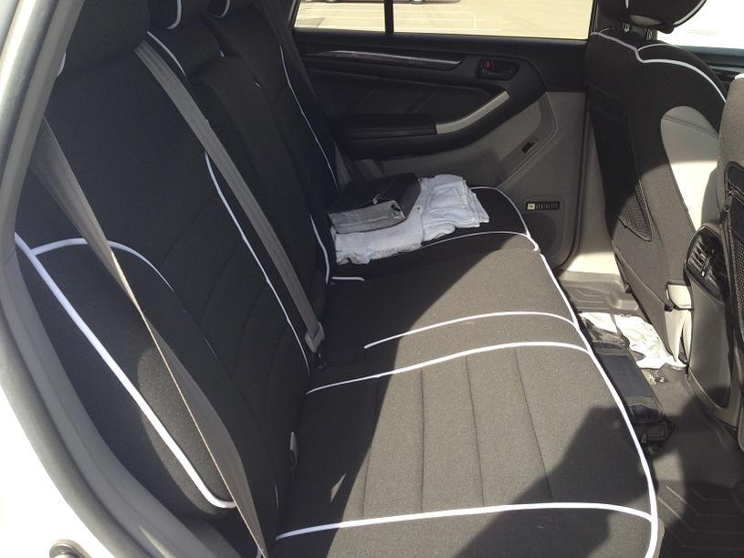

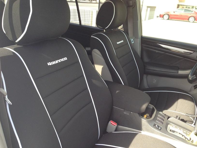

Next, I found some lightly used Wet Okole seat covers from another T4R member - black with white piping and the 5th gen logo on the front seats. I'm not sure why it has a gap on the sides, but for half price, I couldn't complain much.

The gap on the side of the Wet Okole seat covers is for the side airbags. You have the driver and passenger covers switched. The hole for the airbags goes on the outside of the seat.
Ah. Good to know. Edited plans for the future include switching the driver and passenger seat covers.

Makes sense then, lighter weight is always welcome in a vehicle too. Truck looks good though, most people would think it's a 4wd
