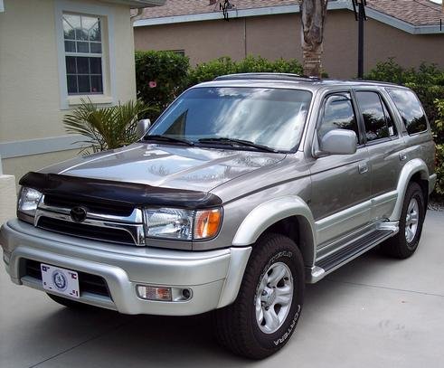

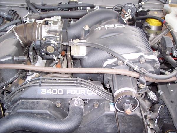

Just got my T4R back from her 100K mile service. At this interval we did new spark plugs and wires (both OEM), changed the oil inside the supercharger - Brian said there was only a drop of oil left in there, although it does not take a lot of oil to beging with - changed the dynamic tensioner, the 3 belts, and changed out the power steering fluid.
He put in new power steering fluid. I told him it needed ATF fluid not PSF. He said what was in there was actually PSF, and not ATF. I had never changed the power steering fluid before so what was in there was original - it came from Toyota that way. I am a bit concerned about this but it has gone 100K without an issue so maybe I'm being overly concerned?
