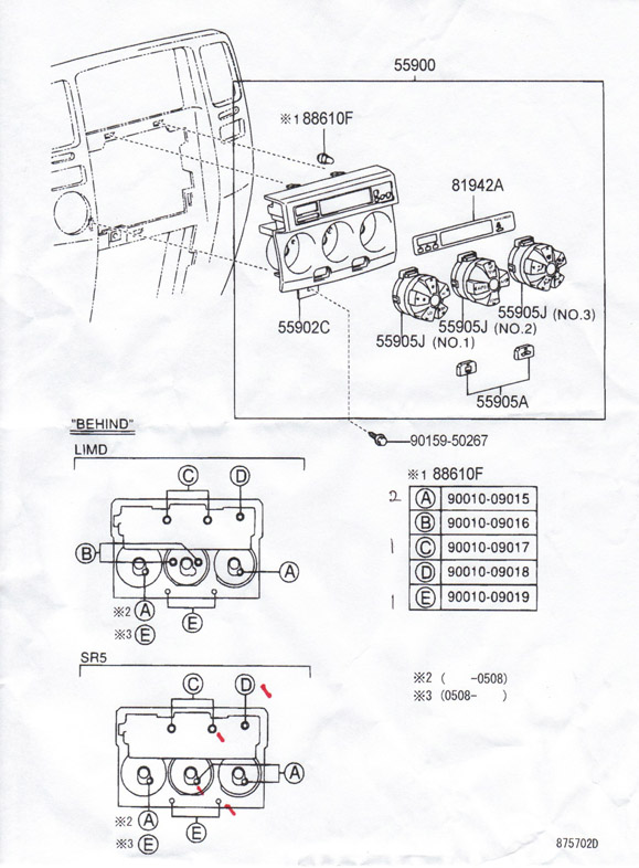

Yes it should be lit when lights are on.
9001009017 you will need 2
9001009018 you will need 1

Just to clarify, the 2 bulbs you need are for the back lit display, the single bulb is for the two buttons..Mode and Reset.
No worries. The diagram you posted was awesome and I already picked up a pair for the display and installed them. Thanks for the help!
