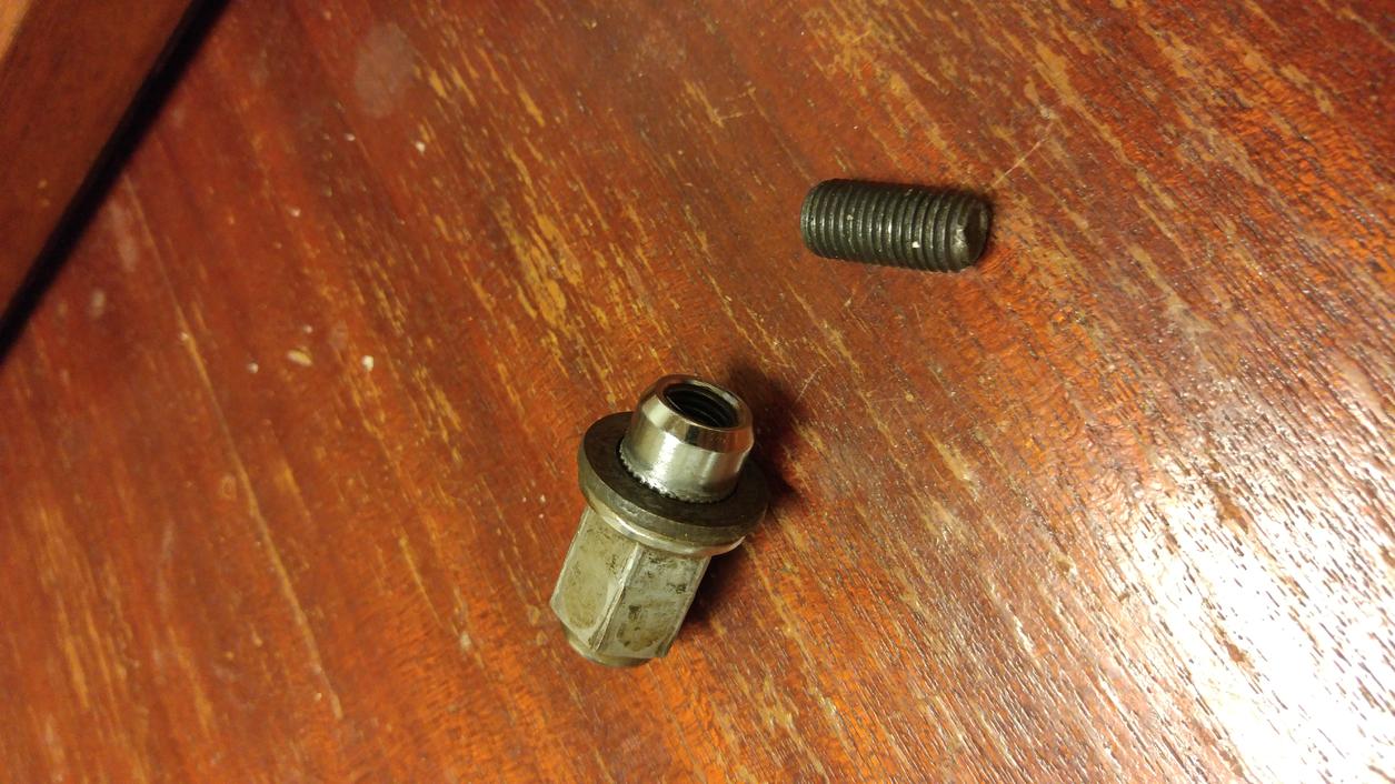

I took out the brakes, I saw there was wasn't an anti squeal shim nor was there any brake grease... so took everything out applied some brake grease , lubed the guide pins and put it backtogether. we were putting the tire back on and as we were lightning the lug nut, the stud (Where the lug nut attaches too)snapped off.

Thankfully I've never had it happen but it seems to be an easy enough fix. The studs are $1.99 each at NAPA:
http://www.toyota-4runner.org/problems-warranty-issues/53857-snapped-wheel-lug-very-easy-fix.html
If that doesn't help try a google search, "broken wheel stud 4Runner" or "Tacoma" since they're similar.
It sounds like this is something you can do since you know a little about brakes. It would be nice if you could find an honest independent foreign auto repair place. Ask around. Once they are a few years old Toyota dealers really charge a lot for repairs. They are in the business of selling new cars. Good luck!
P.S. WD/40 is not the greatest for loosening nuts. It's not a lubricant. Get some Liquid Wrench or Kroil (the best).

I thought the wheel hub needs to come off... hence why i got scared.
i didnt realize it was a 2-4 dollar part :D

I had this happen once also, so I put the tire back on minus the one lug drove to autozone and got the $2 stud drove home drove the old one out with a hammer and punch then put the other one in using the a spare lug nut and some big washers like a puller. I hope you understand how I used the nut to pull the stud in.
