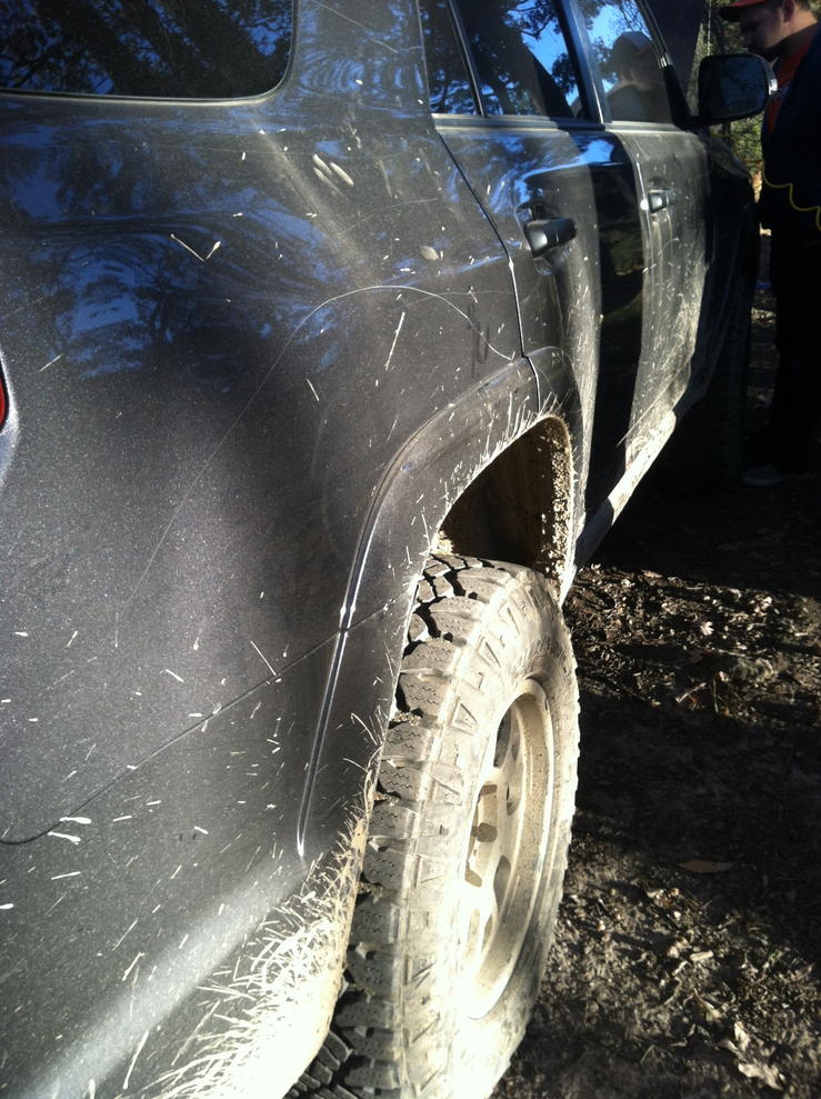

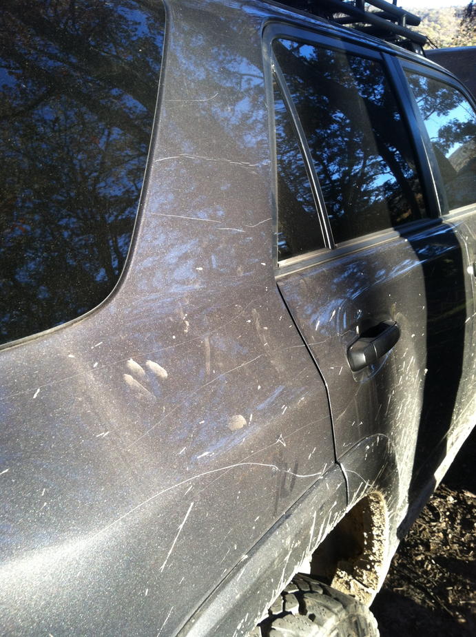

I used to worry about stuff like that.
Then I went camping with these guys, and...:fear:
Now I don't worry about it so much.
