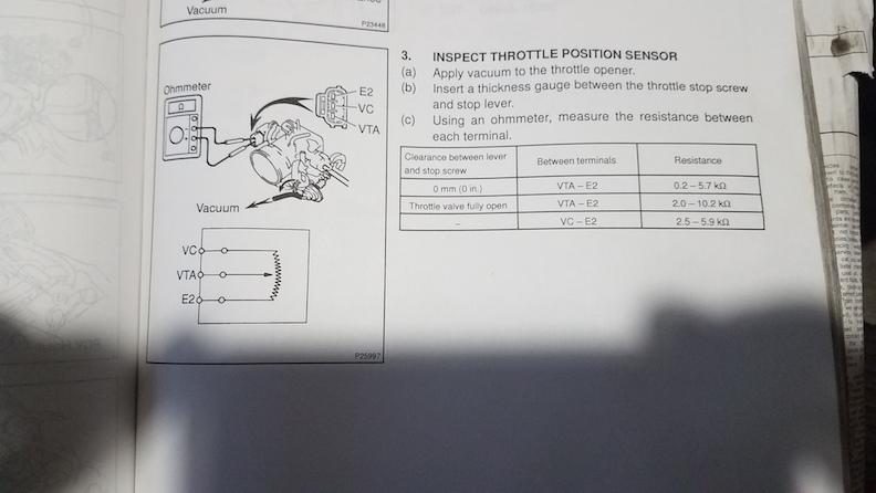

Below is a page out of my 2000 FSM regarding testing the TPS.
Thank you once again Tim! I only have the free online one for the 2002 so it didn't have the full testing procedure since the TPS changed. Turns out VC-E2 is out of spec under vacuum and has a reading of 7.9K ohms. Max is 5.9K ohms. New TPS it is.
You're welcome Jerod. I'm curious, what did you use to apply vacuum to the hose?
A vacuum, go figure. I have a 20V hand held vacuum that has a pretty narrow opening with good suction so I just stuffed a long piece of vacuum tubing inside, taped it up airtight and put the hose on the vacuum barb on the throttle body. I've done this a few times for diagnosing and works like a charm.
