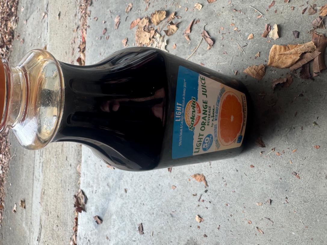

So I assessed the short and long term fuel trims and were all within 5% (one set was within 1% cant remember whether short or long) directly after this fiasco while I was parked, same day. I then dug around a bit online, youtube, and the forums and ultimately decided to do a drain and fill of the transmission. I waited about 1.5 hr to cool off a bit and then drained about 2 qts of dark brown reddish ATF from the vehicle. Then pumped in the same amount through the fill hole. I have previously done this once beforehand in the last year. I shifted through the gears and then once warm I took it for a spin and idle was back to normal, shifting of the gears was normal, and power/acceleration went back to normal. Highway speeds this morning on the way to work were good as well as the way back.
I did have the thought while at work that my sparkplugs are 5 years old and about 40,000 miles ago (Very fortunate my work and school commutes have been very short the last few years). Exhaust does have a slight leak between the cat and the header (working on that), nothing to trip a code though. Attached is a photo of the state of ATF fluid I pulled out of the car.

Some scanners can see the difference between the crankshaft speed and transmission speed, to show if you torque converter is shuttering. Your fluid does look a little dark, did you strain it through a paper towel looking for debris? If it's full of clutch material, most people will say don't touch it, but if it's clean then you could probably (important to remember) gain from a full filter and refill. There's always some risk with old transmissions.
Honestly if it was mine and everything was working currently, I'd wait to do the full flush until I see how things go for 2-3000 miles.
