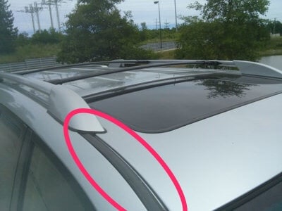

I have a leak in the roof of my 4Runner that is rapidly getting worse. It leaks to the point that a solid stream will shoot into the driver and/or passenger's laps when it rains. (Yes it leaks on both sides) There's a seal on the roof above the doors that for reasons unbeknownst to me are extremely loose. Loose enough I can pick it up and slide my entire hand under it without stretching it at all. Why did this happen? How do I fix it ASAP? It's soaking into my floorboards and my whole car smells sour. I've tried so hard to get the smell out and I can't do that either especially because it gets undone as soon as it rains. Any and all help is appreciated!!
I couldn't take a picture of my 4Runner right now, but I found this picture on google and circled the seal in question.

Check your sunroof drains. Use weed whacker wire to clear them.
It's very unlikely the area that you pointed out where your roof is leaking from.

The side seals have little to nothing to do with your leak. The most likely issue is the sunroof drains themselves being clogged, it's extremely common with sunroofs.
