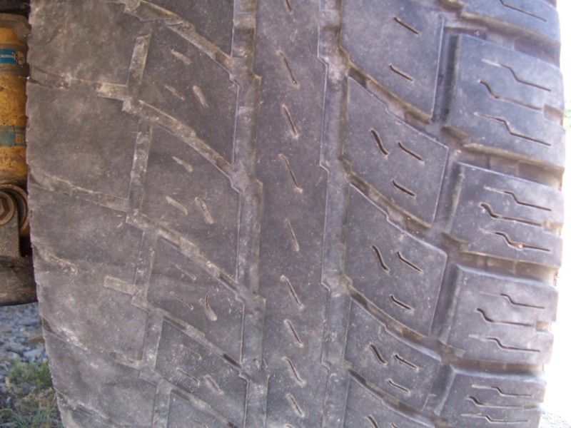

here is a pic of the wear

i agree with Stick Figure, steering rack bushings are a known problem.
another thing to check is the inner tie rod...lift the front of the truck and shimmy the wheel back and fourth (like you're steering the truck from the tire), there should be NO excessive play and if there is, look into swapping out those inner tie rods as well.

Although steering rack issues are well known on 3rd gens, your problem sounds like a Lower ball joint issue. I am not a mechanic but the exact same thing happened to my truck last year & it was the lower ball joints that caused it, they were starting to fail and the tires are the first sign.
If not replaced yours will likely go all the way. There are several threads on this forum of 3rd Gen. 4Runner's that crashed out on the highway when the car's front wheel fell off at 80 mph due to LBJs.
