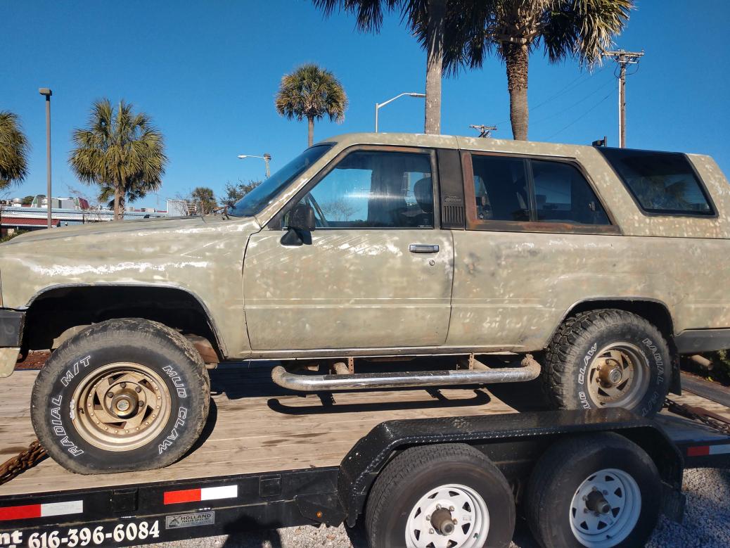

Finally picked up a 1st gen body for my TDI solid axle set up. So here comes the updated pictures. I have documentation of everything on my YouTube channel.

It's been completed once already just reinstalling with a 4runner body on it and making some adjustments to the prototype designs. FMIC, tilted radiator better piping, modified cooling routing.
