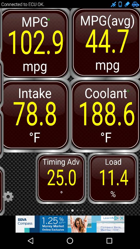

Ordered a BAFX 34tS Bluetooth OBDII scan tool from Amazon last week and been playing around withthe free version of Torque Pro.
Some of the output you get is funny, but some, like temps, are kinda key
I have also been playing around with engine load and over drive, very interesting to see what the ECU thinks under various conditions
FWIW, I've never seen my coolant temp over 192 degrees F and I guess until I get the Pro version of the app, Trans Temp is not an option in the Lite version of the app.

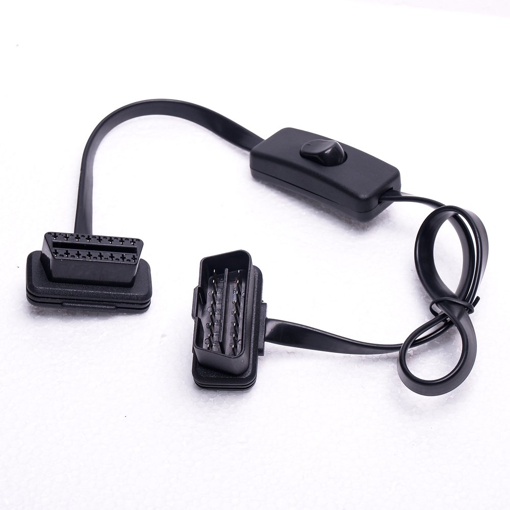

I picked up one of these.
It makes it easy to turn it off as long as I remember to.
https://www.amazon.com/Tonsiki-Female-Diagnostic-Extension-battery/dp/B00UR5XBMW
The switch is good, and I wish it were closer to the other end of the cable, but also I would rather hardwire it into the switched radio power wiring since it's all right there. Personally I don't need another thing to have to remember to turn off or on :shocked:
I might just buy this and bypass the switch and direct wire it

I noticed you did not have trans. temp on your screenshot. If your truck is a 99+ you can get the trans temp with the device you purchased.
I need to purchase the $5 app to get Trans Temp - I've just been lazy :)
Thanks [MENTION=134889]alumarine[/MENTION]!
I use the switch most of the time, its no big deal, but since so many people are saying the draw is so minimal, I might get rid of it, I'm tired of it being another cable in my way across my console

I use the same switch and labeled the sides on and off. I put velcro on the reader and velcroed it in the space under the ashtray. I ziptied the the extra cable under the dash and I think it's a decently clean look. I turn it off every time I leave the car. It's habit now. Sometimes my vehicle can sit for a couple weeks if I'm out on a fire so I'd hate to come back to a dead battery. Also, the OBDII port faces down and gravity works against you to hold the reader in on a bumpy road and it can fall out. Finally, since the reader hangs down, I've bumped it with my right foot a couple times and it would suck to crack your port. So, the on/off switch does more than just offer you the ability to shut the reader off. I highly recommend this switch to anyone who uses an OBDII reader.

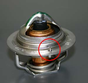

not sure if you're messing with me or being serious lol :)
run that by me again?
Sadly, not messing with you.
The jiggle valve is the little loose bit of metal that is there to pass air bubbles. For whatever reason, the 5vz needs it on the bottom. Almost all other engines it should be at the top (where air bubbles go!).

interesting
I havent done anything with the thermostat, it was replaced last when the timing belt was done at 118k.
you think it's worth delving into at this point? i have about a month to go before the high ambient temp maxes out at 55
