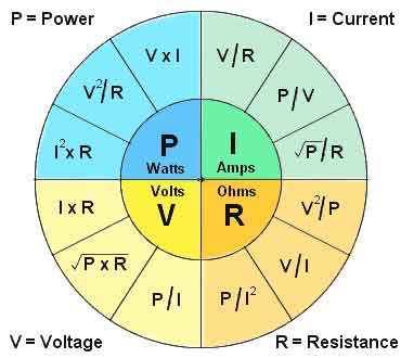

Ohm's law
google Ohm's Law
and multiply the light ratings x2
like foudwd1 said
