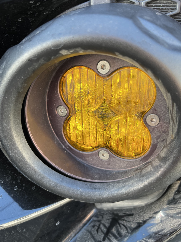

I just noticed a modest amount of moisture inside the light…. What are my options? Not exactly thrilled to see this
https://i.postimg.cc/hvwpxq50/9-FDB12-EE-C412-4-BD5-BFAD-76-D92-E4561-DC.jpg
