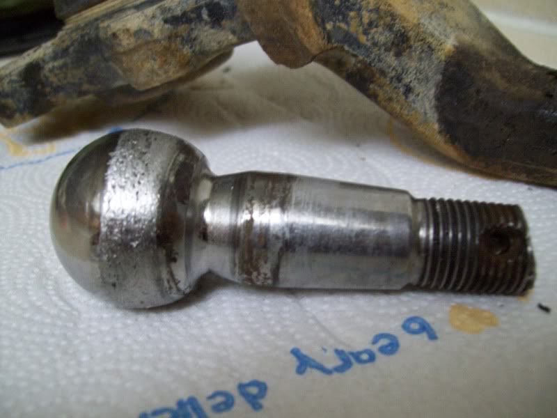

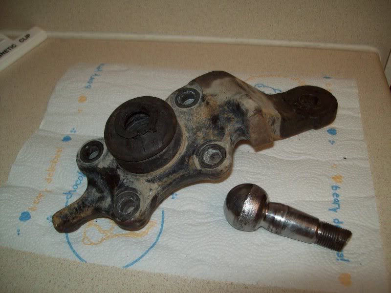

My credit card now has a $1000 hole burned in it but at least my insurance covered a little over half of the cost and I have my 4runner back minus the bump stops which are on order on their dime; the dealer admitted that they were left off and should be there.
Any who, how is this for failure of the ball joint?

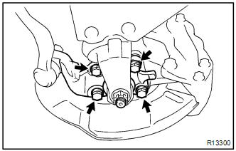

Ok, so stupid question, but the new OEM LBJ comes with the bolts and nuts right? Mine are riveted on, so I will have to cut them off.
And new castle nut?
And new castle nut?
Are you sure you're looking at the right part?
It's the one with the bolts, not the one riveted to the control arm.
And new castle nut?
OEM ball joints are DEFINITELY not riveted on- there's not too many rivets on the general market that can hold a ball joint together.
It'll only come with the new nut for the joint, you reuse the bolts. No nuts for the bolts- they thread into the knuckle.
Yeah, you're right, I was looking at the wrong spot.
And new castle nut?

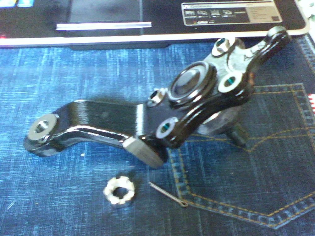

Heres everything the lowers come with. I ordered these and the uppers from Toyota a few weeks ago, just havent had time to install yet. They dont come with the bolts. Have to salvage them when removing the old joints. But you shouldnt have to cut anything.
Sorry about picure quality by the way. Was taken with a phone camera.
Of course, you can order the bolts from Toyota seperately. I may do that just for peace of mind.
Did it come with a new boot?
