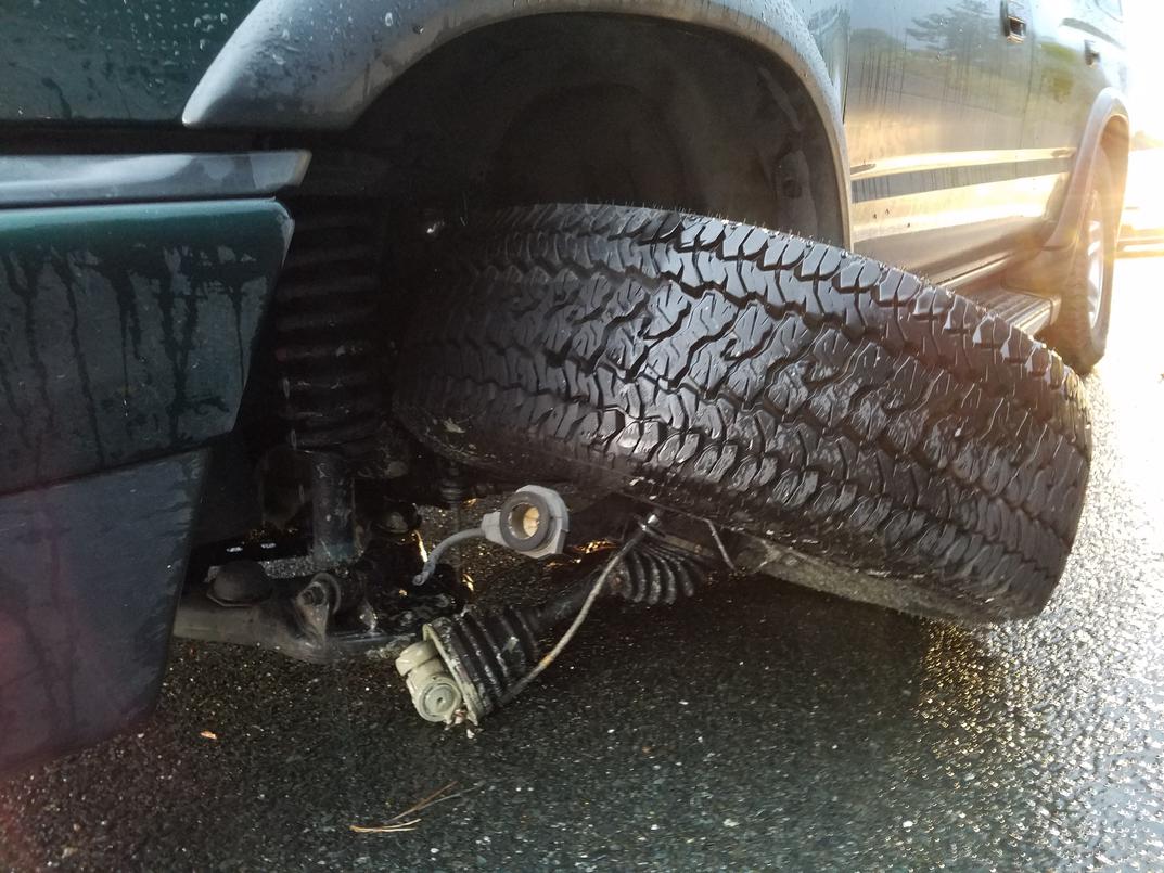

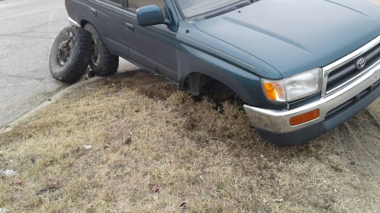

On the hwy when the driver's side ball joint failed.
225k miles on the 1999 4runner highlander.
Everyone was ok. It was raining hard so were going about 50mph. The steering started to get a little harder than normal and a few days before. Didn't think anything of it. No notice, just dropped. Luckily, the tire got caught under the truck. Could have been a lot worst. Repaired both sides just in case.
Stopped in seconds on the left side of the hwy.
I did not know this was a issue prior to it happening.
Thank you to everyone's concerns.

Sorry you had a balljoint failure. Sort of curious though. Had you heard of the lower balljoint failure problem with our rigs prior to this incident? Was there any symptoms you noticed prior to the failure?
Saw a stock 1g Tacoma with a ball joint failure yesterday on side of the road.
Glad you got your rig stopped safely. At that speed could have been way worse.
Please tell us how you got it stopped and what it was like...if you are up to it. How fast were you going?
Very glad you're ok.
Seriously glad you're OK. Can't imagine...When the time comes, there are many on here ready to walk you through the repair. It seems paradoxical to say this after an OEM LBJ failure, but you must use OEM LBJ's when you're ready to replace them.

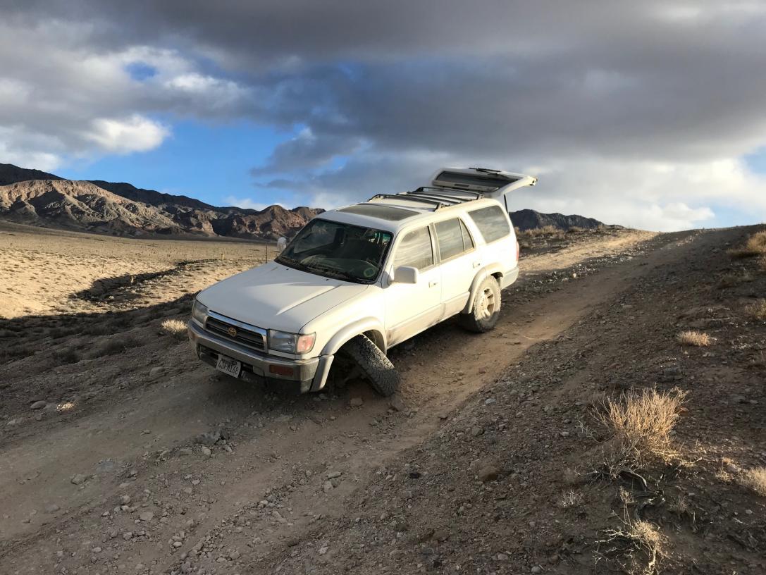

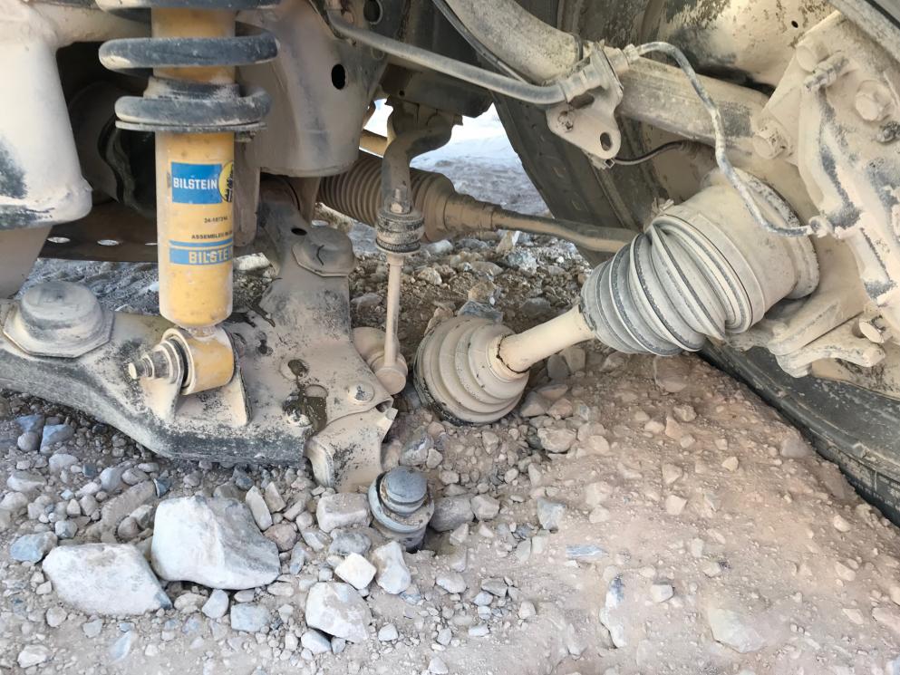

Hi all, I too experienced the sad sad LBJ failure on my '97 4runner at 291,000 miles on New Years Eve. I'm writing an article about the experience and would like to talk to anyone who has had the same problem... if you're interested in sharing your story, reply to this and we'll get in touch offline. I can keep it anonymous if you prefer. Deadline to get it in to my editor is Jan 16, 2019, next week, so hopefully some of you respond! I want to get the word out for safety's sake.
Ouch man. I'm curious...with that mileage when were they last replaced?
Are you a writer of sorts? Don't have any personal failure stories but would be able to support you on any technical related topics if you need. Can't believe this serious design flaw has been out for 20 years now with little formal action having been taken. Especially on such a popular vehicle of which the safety risk exists out there on countless vehicles still in service.
If you do write an article please mention that because of this forum and it's community there are countless 3rd Gen owners that have avoided this failure, myself included, ive replaced mine preodically over the last 350,000 miles and 18 years twice with oem lbj's.
