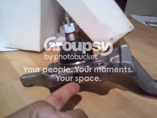

Picked up my ball joints today and got a quick question. Is this for installing a zerk fitting:
2011-05-05220414.jpg~original
