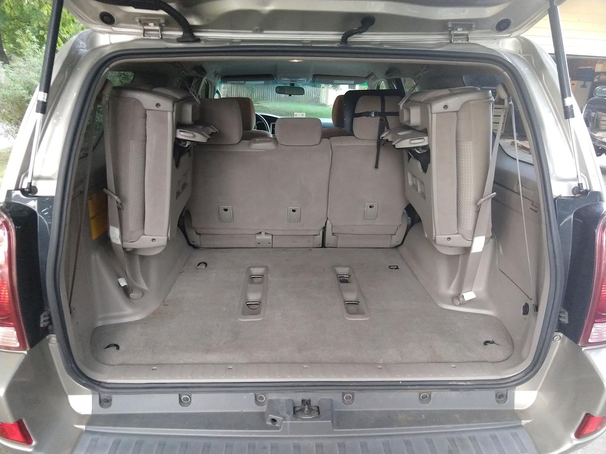

Looks clean. Jealous of your 3rd row.
Yeah we were looking for a bit of a unicorn. Wanted an 04 with the 4.7, 4wd, and the third row. Felt pretty lucky to find this within a few hours drive.
Ideally we wanted to be closer to 100k miles, but this is super clean for the age and miles.
