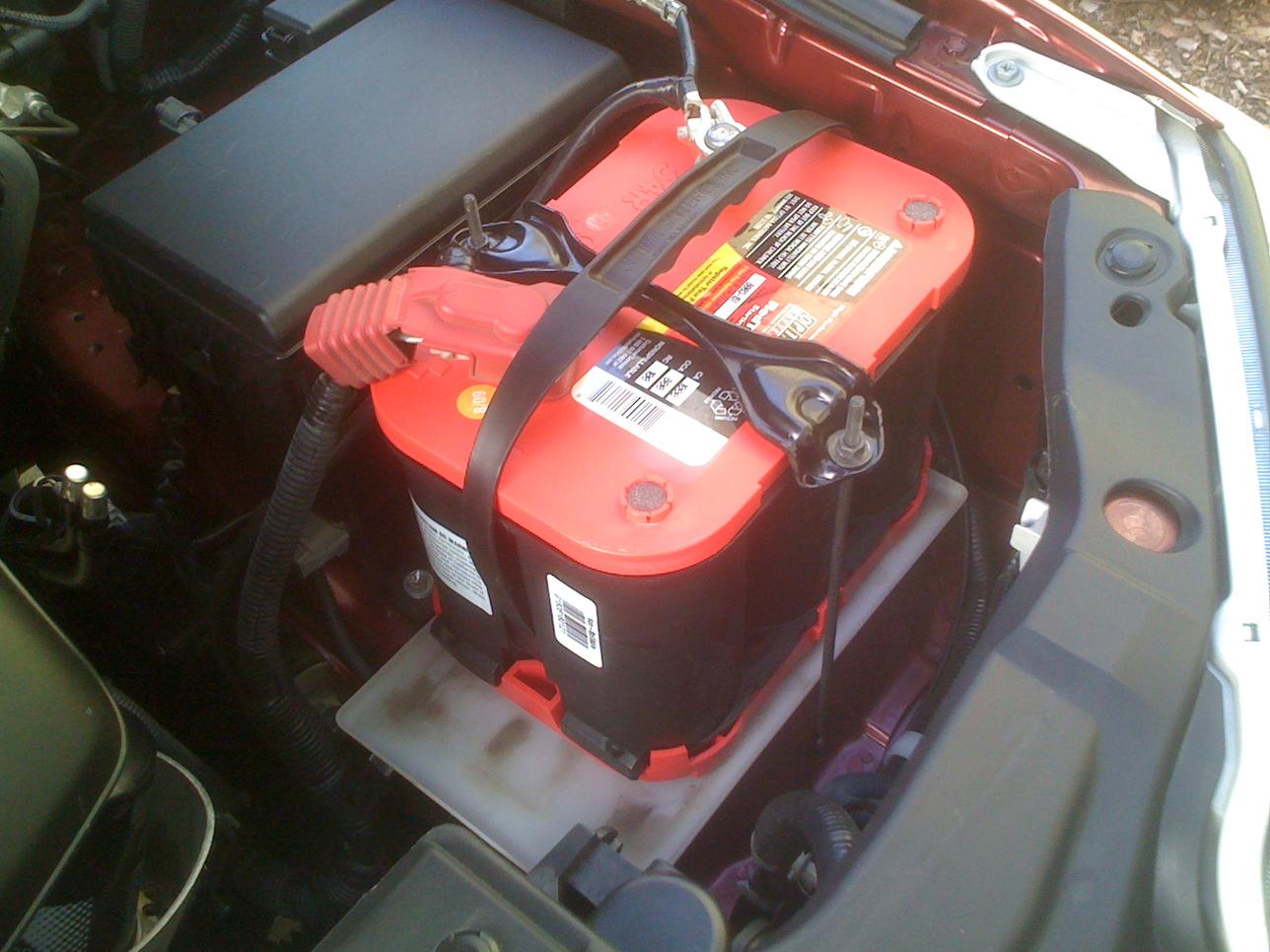

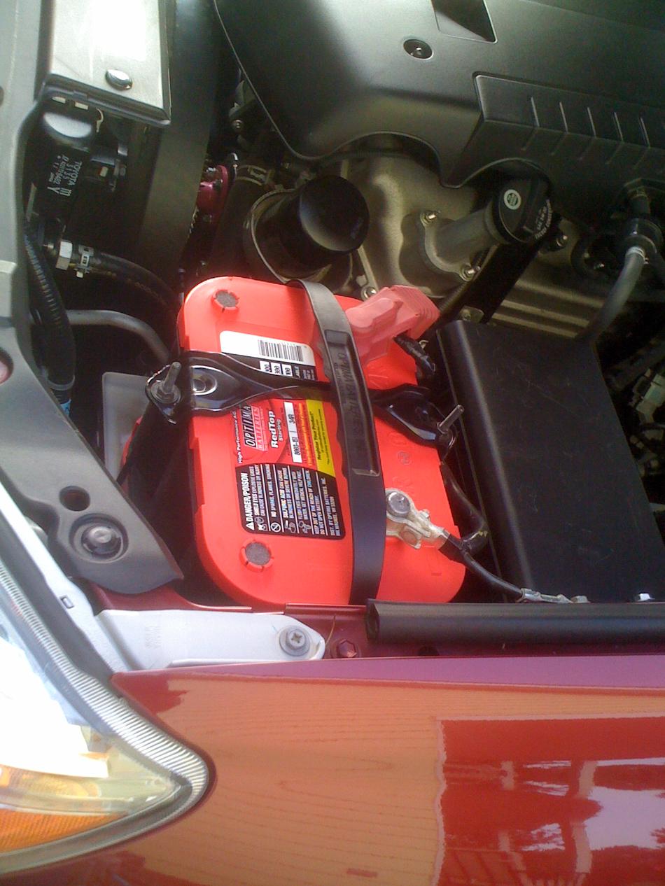

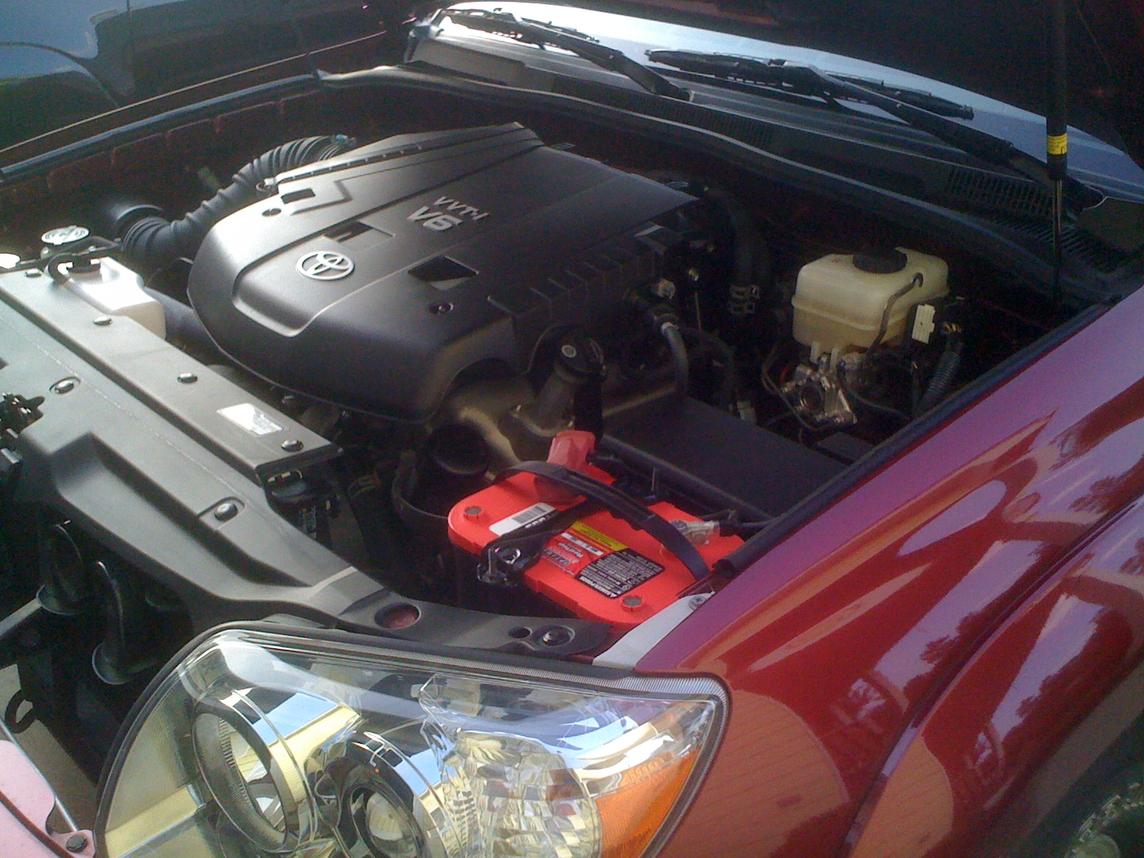

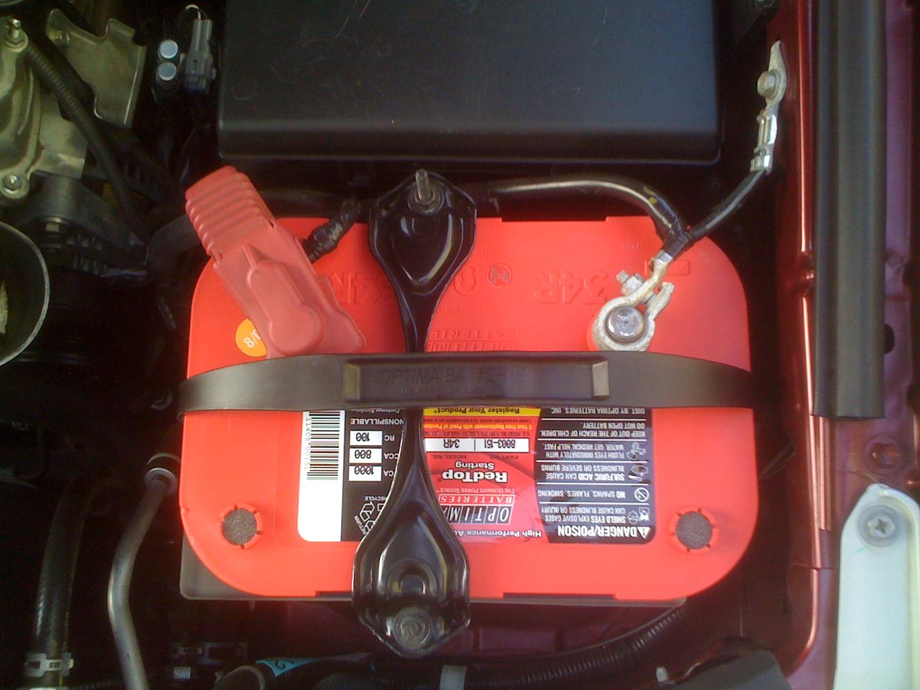

Optima 34R Installed!!
Installed my Optima 34R last night. Actually I removed the Factory Panasonic battery from my 08 and put it in my 04 (Which really needed a battery) and put the Optima in the 08. Only took me 10-15 minutes to remove two batteries and install two. If you do it fast enough you don't even lose the radio presets. I did have to reinitialize all the windows and moonroof in both. Very easy.
I was happy with the shipping from Amazon, Ordered on 8/22 - received on 8/26. It even came with the $25 rebate postcard. You only have until 8/31 to get in on the rebate. $117 after rebate and free shipping is not a bad deal.
The Height adapter is required. The cables were a bit of a strech but worked out fine. The only tool/tools needed was a 10mm openend wrench or socket.
