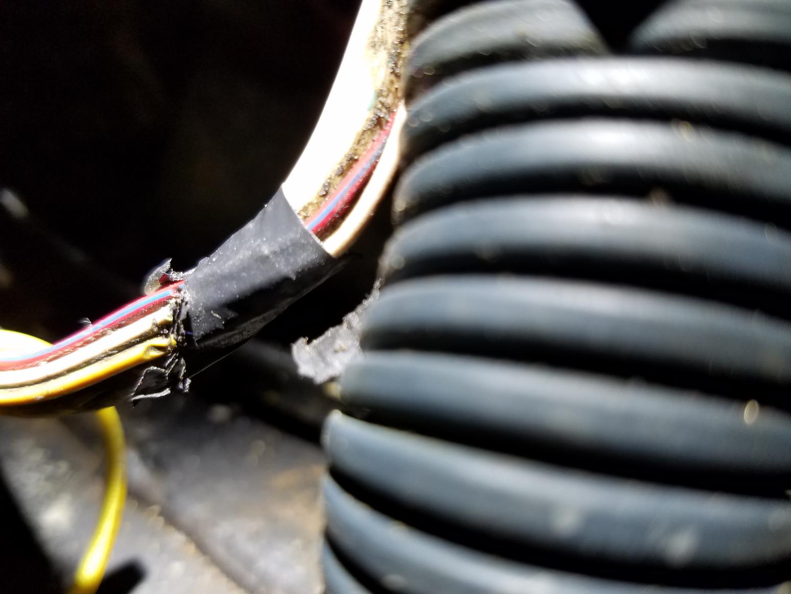

So there was nothing wrong with my splicing. Rather, it was a broken wire right where it branches off the fatter main harness. Hard to tell by the picture, but the break was under the insulation. Not sure if the tape was factory, or if it was the previous owners quick fix, but the wire loom is what tore the electrical tape.

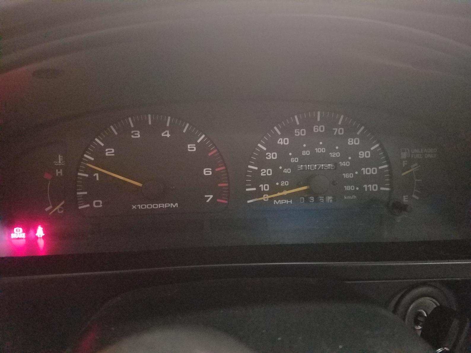

Its late. I was happy to fix it. Didn't stick around long enough to check my volts. All I know is I cut this section out, spliced in a new one and started the truck. NO ALTERNATOR LIGHT NOW!!!
Disregard my high idle. I started the vehicle long enough to verify the light was off and snapped a picture.
Thank you to everyone who helped me with the resources to diagnose this.
