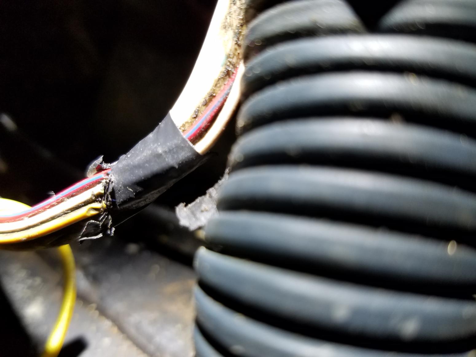

Problem solved! Terminal 3 on the alternator plug (which is the sense wire) had no power. I checked and had no continuity between there and Plug EA1, terminal 4 (EA1 is the plug connecting alternator and starter to the Engine Fuse Box). After looking into it, I found a break in the wire (white) right where it branches from the main engine harness to alternator. There was a piece of electrical tape semi-covering it. Not sure if this was factory or a previous owners fix. The tape and the wire was broken due to rubbing on the wire loom protecting the main harness. Opened up the main harness, made the repair and retaped and wireloomed everything.
Without the sense wire, the alternator sees a dead battery (or no battery) and ramps up the voltage to compensate. By the time i figured this out, she was charging @ 15.4V. Apparently, this is why alternators and battery's fail prematurely. The only electrical issues I've developed in this time is I've lost the piezo "chirper" for my alarm and my OBD2 port wont connect with the ECU. Still runs, drives, and charges great. I'll have to look into the other 2 issues. May or may not have been related to overcharging.

Hi, I found broken white wire where three wires from alternator plug meet large loom from beside battery. I was following advice from other post here with picture of problem area.
I cannot find it but it was super advice.
Fixed Wire Problem Gone!

PS Confirm Break by Continuity Test from Fuse No 3 in Fuse Box behind Battery to White Wire at Alternator Plug!
Good catch.
Toyota components are almost bullet-proof. problems are caused by poor connection, assembly or maintenance.
That's probably the "S" wire. Sends battery voltage back for regulator to sense it. IF that were broken, regulator would think battery is completely discharged and will keep on sending higher voltage to battery, thereby over-charging it.
