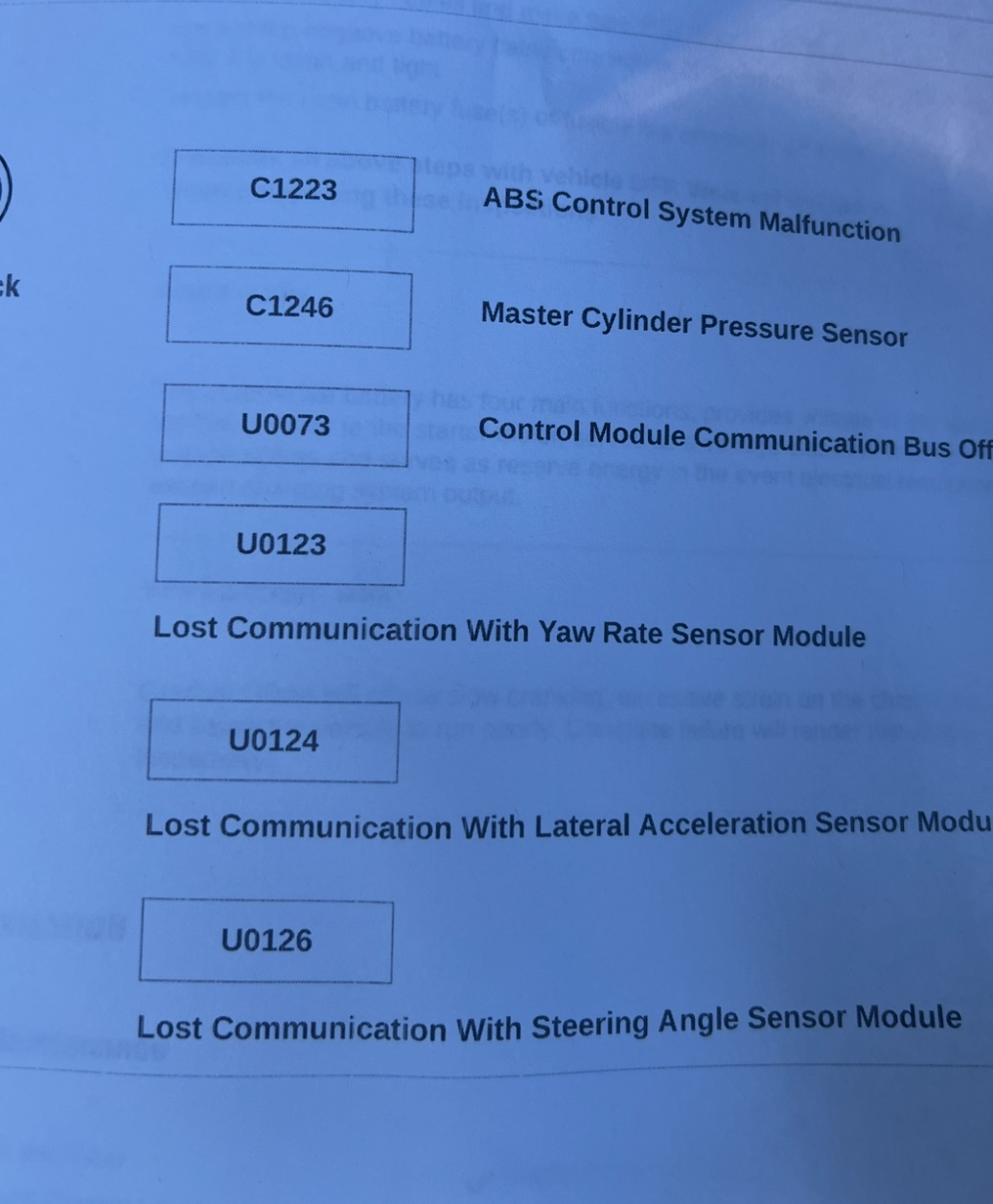

Starting a few weeks ago I noticed the stability control will beep when I first start driving the 4Runner.
I was confused at first because I’ve only heard it beep three times ever before.
Pulled the codes and it’s “lost communication with Yaw, Lateral Acceleration and Steering Angle modules” & "Control Module Communications Bus Off"
I did some cursory research and tried the recommended fixes.
Did a ZPC by jumping the pins, checked my battery terminals and voltage and it’s all fine.
I don’t have any lights on the dash and everything works properly, so I’m not sure if it’s something I need to address right away.
