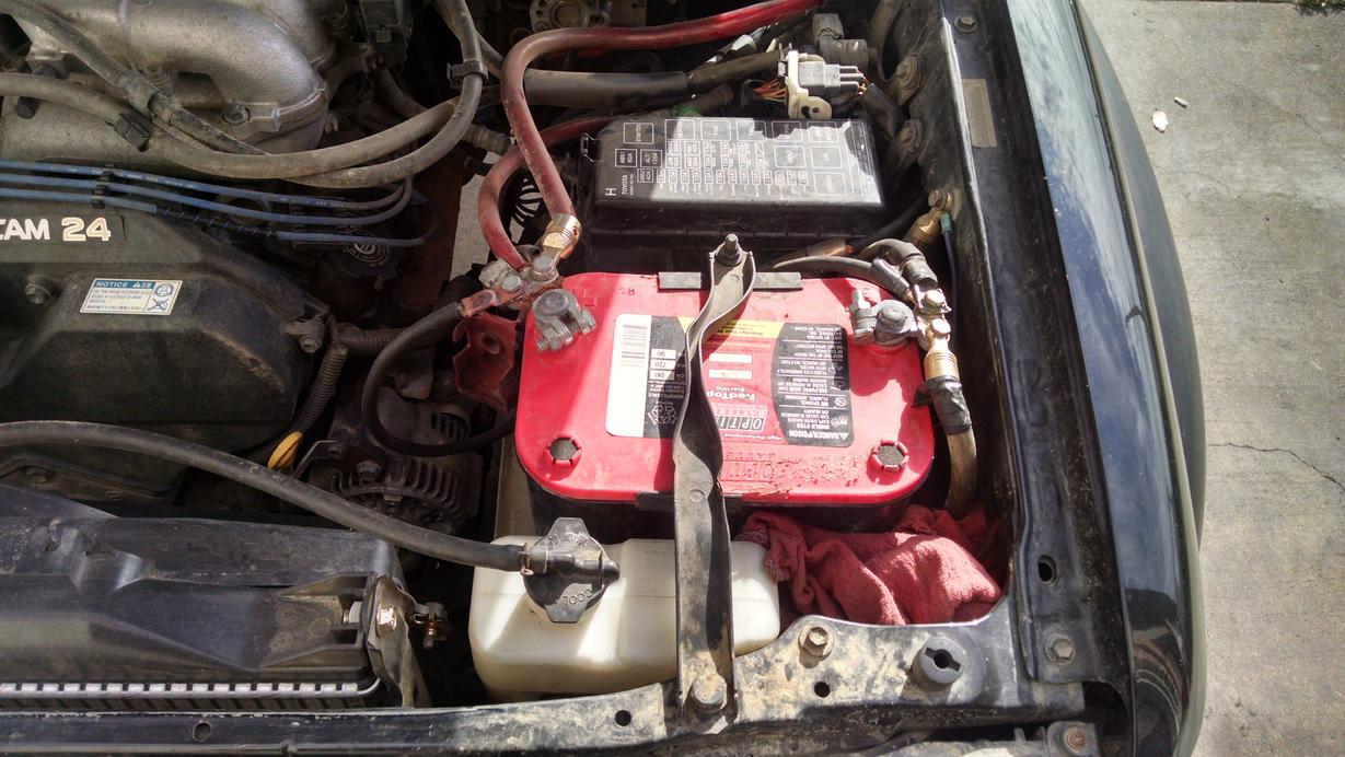

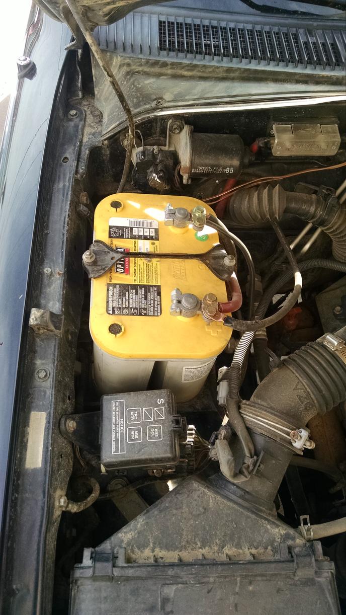

I don't run the yellow top in the stock location. I'd be willing to be that it would still fit snug there. The red top is actually a little smaller. The previous owner who originally installed the red top 4 years ago didn't secure it properly, bending the tab on the hold down bracket so I've had to modify it but I know that it can be properly secured with no modification.
Those rags aren't doing anything to hold the red top in place BTW. They're there so I can check my oil and stuff while getting gas!

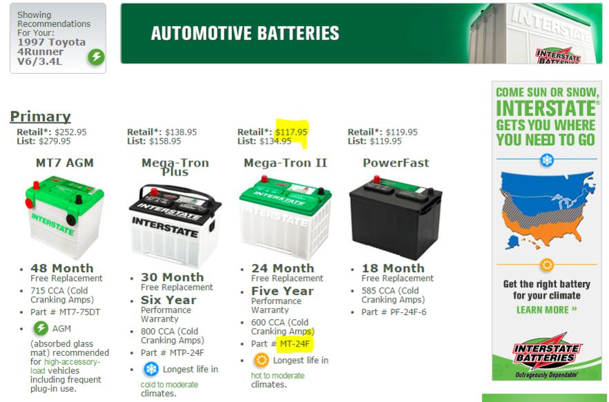

Recently I needed a new battery for my 08 TL but Costco didn't sell a compatible model so I went online and looked at Interstate's website, found the correct one, and went to my local Interstate vendor. The closest one was Firestone Auto and they gave me 10% off the website price.
Car and Truck Automotive Batteries - Buy a Vehicle Battery for Cars or Trucks | Interstate Batteries - Automotive / Truck
Interstate's website says the OEM CCA value for my 97 V6 4Runner was 380 CCA. They offer two batteries. I suggest you go for the better one which is 580 or 600 CCA for the MegaTron II.
$118 - 10% = $106 + tax
