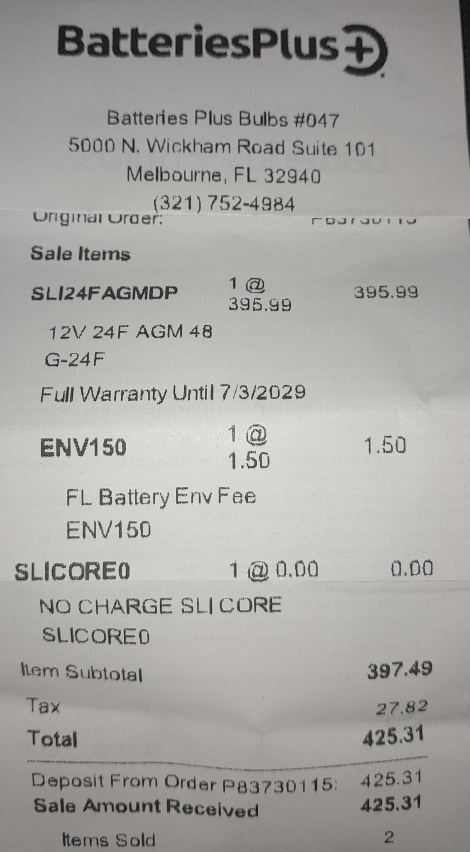

I use SLI24FAGMDP X2Power Car and Truck Battery | Premium AGM | 840CCA | Group Size 24F for my 16' TRD Pro
Best battery I've ever owned. First one lasted around 9 years. Buy once, cry once.
Coincidentally I just replaced it yesterday. It would still start, but was laboring pretty hard. Voltage was still holding, so the door locks were working, but putting a load tester on it showed around 200 CCA.
They've gone up about 30 to 40 bucks since I first bought one back 2016, but still worth it imo. Unfortunately most people can't afford it, or will just scoff at the cost.
My reasoning is a wet cell in an off road vehicle is weepy and will start eroding shit. If your 4Runner is just a grocery/errand/family trip mobile, with no offroading, a standard wet cell is most likely good enough.
Duracell is making pretty good "middle of the road" budget batteries. My Son has had one in his 1st gen Tundra for a couple years now.
Also, I can't deny that the Toyota True Start batteries are good as well.
