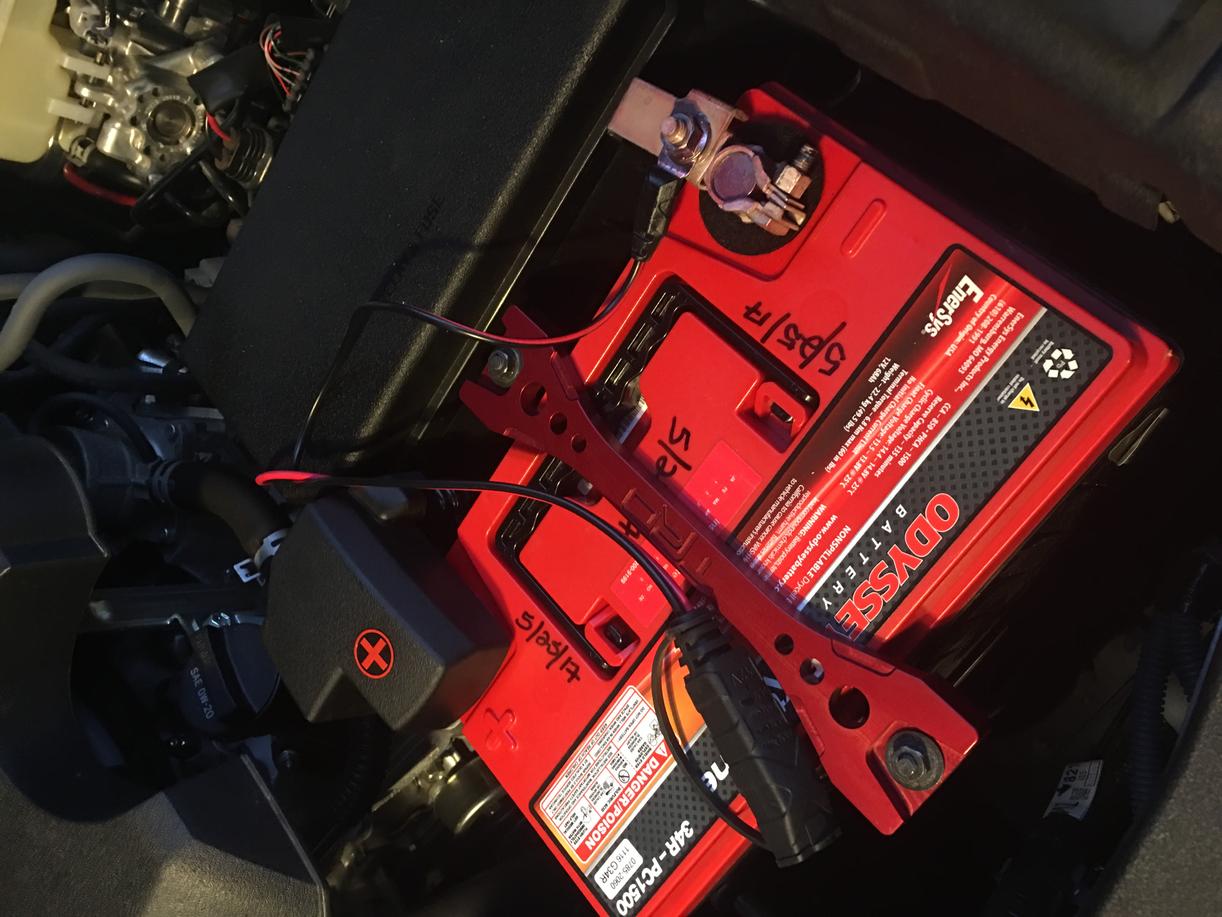

I ended up going with the 34R Odyssey, which will more than serve my needs for the foreseeable future.
Thanks for all the input!
