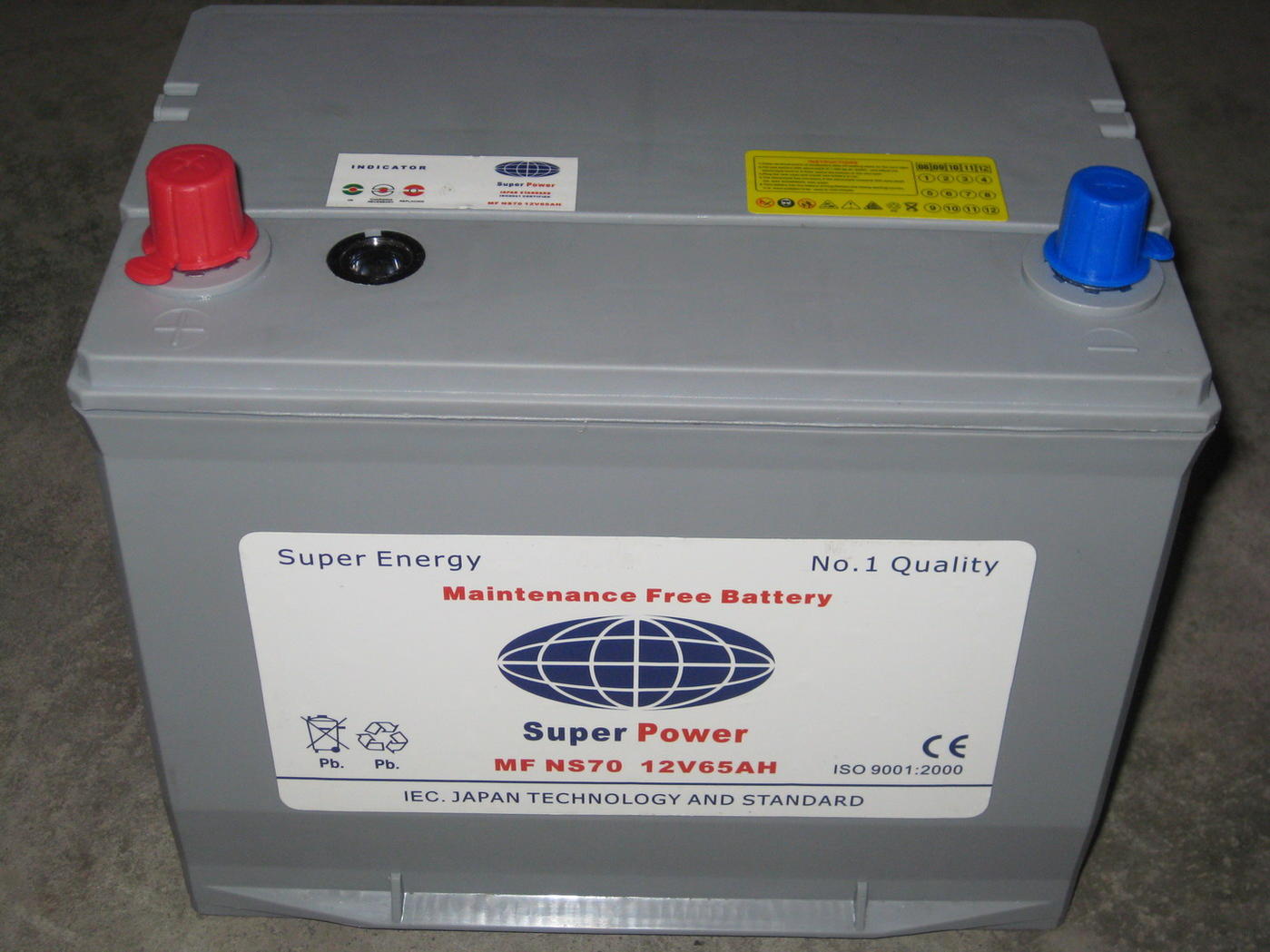

While on that note - the manual talks about color indicators to judge the battery health. Where the heck are they? Anyone care to post a picture?

If it is an original battery then it might not have an eye but
check out picture for the eye (black round thing next to positive terminal).
The problem with the eye is it only tells a small portion of the battery state.
The eye is only one of the battery acid compartments. A car battery has 6 compartments. If you look at the eye and its green, then that compartment is good but you can't tell the conditions of the other ones.
