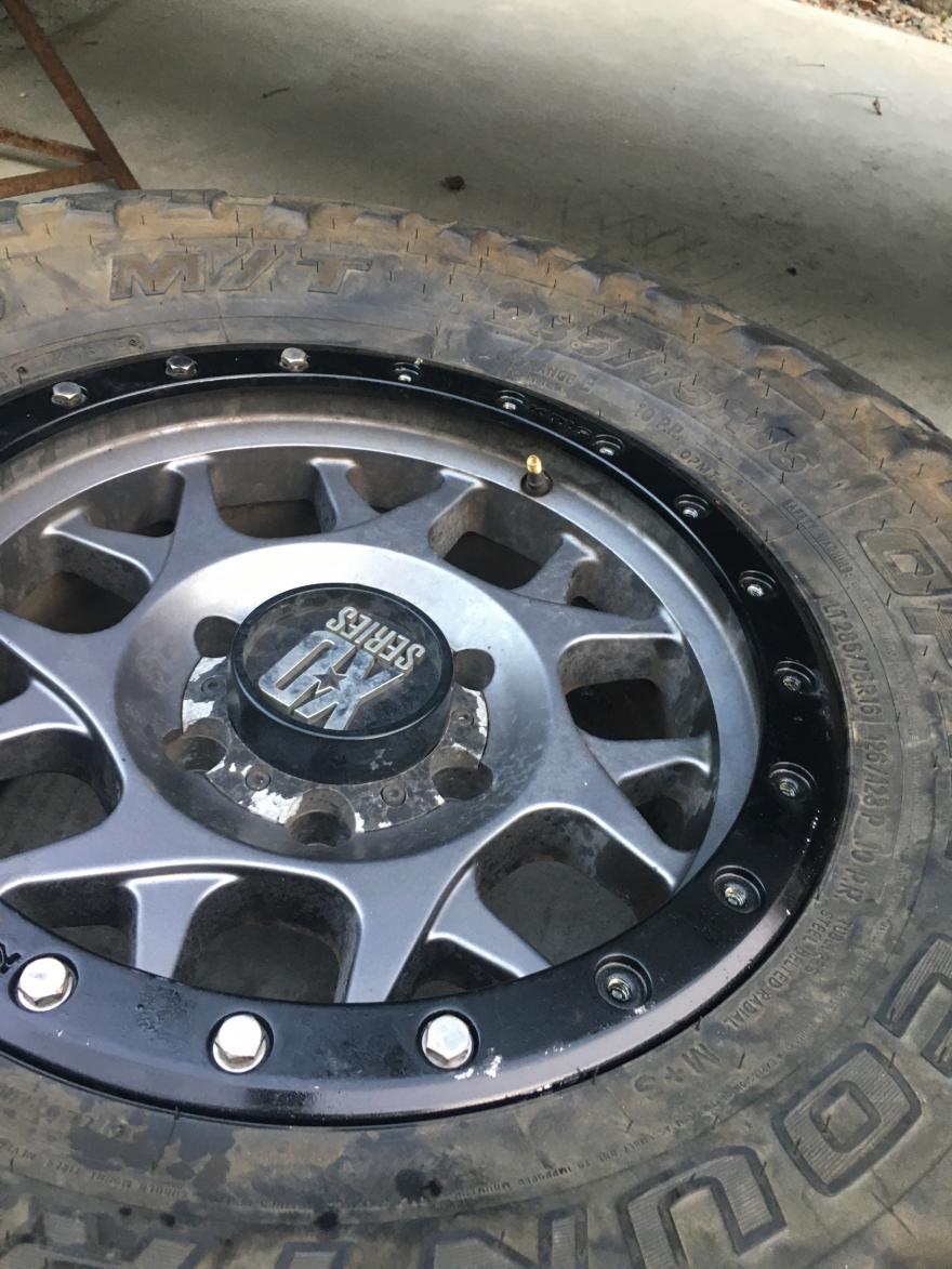

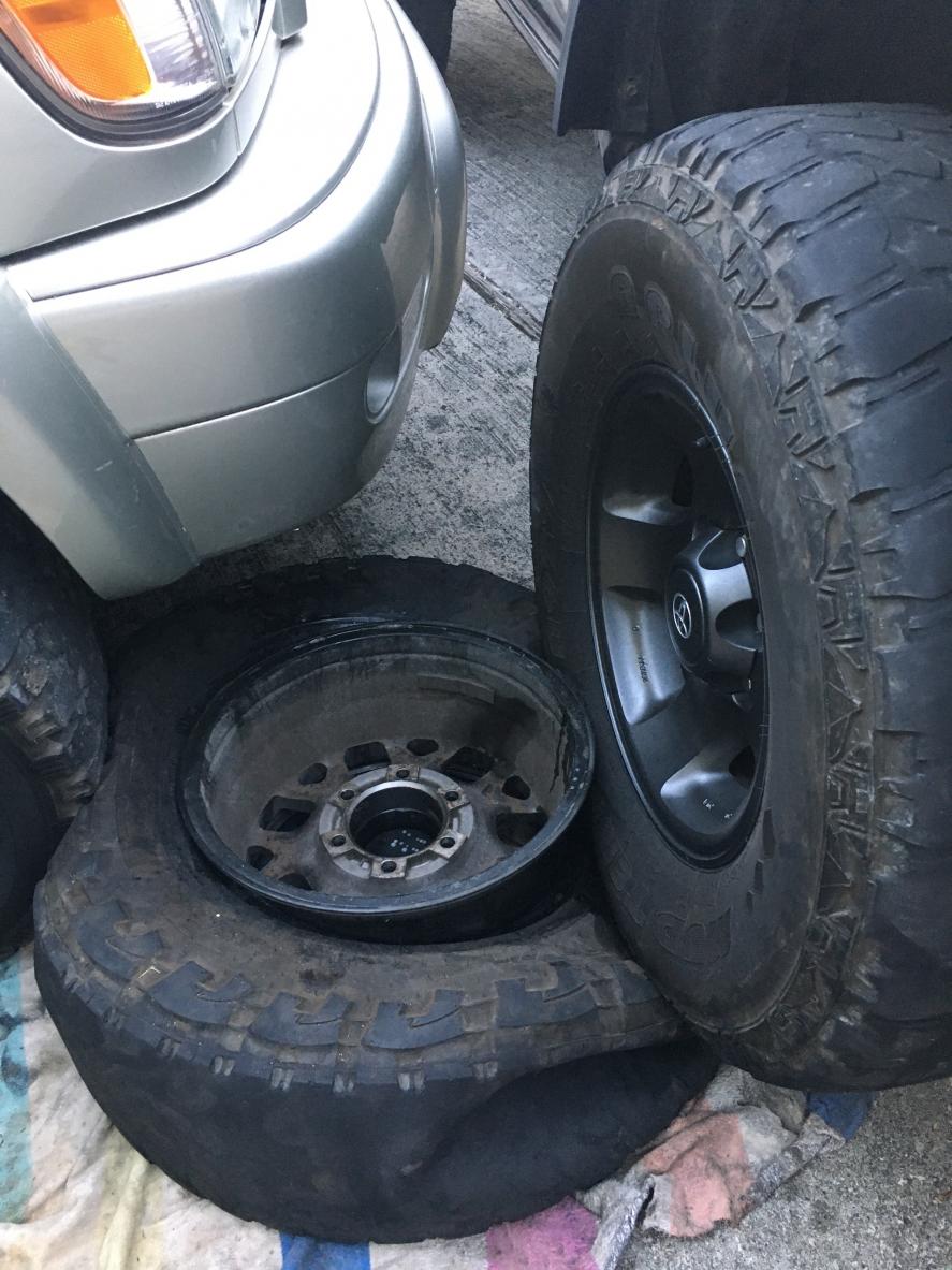

A couple years ago I picked up a used set of KMC XD series rims with some half done Koyo M/T open country 285's. The tires are completely worn out now so i picked up a set of BF Goodrich KO2's and after researching a little bit decided to change them out myself. That and not trusting anyone local to do it since they have probably never seen a bead-lock. Well its not going so good. The ring refuses to come off. I carefully pried it, banged on it with a rubber mallet and even put 30lbs of air pressure in the tire with the ring unbolted. I finally broke the bead on the back side but it took 7 or 8 passes with both 4runners. Its like they red locktited the tire on. I put some deep creep in all the ring holes and will let it sit until sunday when I have more time to work on it. I take it this is not normal at least from the videos I watched. I figured I had 4 hours and could get a couple done but have not even got the first tire off. Any suggestions would be appreciated

Thanks cl4Rk, but I am not sure I want to use much heat on painted aluminum. It is possible I could just burn the whole tire off, but that is not the most environmentally friendly solution
Did you try tightening the bolt up a bit (breaking any kind of surface corrosion), then try loosening it.
Or you could use vibration in form of an impact and or a pneumatic hammer on the bolt.
Thanks HiLife, I will give that a try. I tried to put a longer bolt in there to lift the ring but the ring bolts seem to be a finer not common thread, and being it is just threaded into aluminum I need to be careful.
Well i figured out the problem and once again its me. Took a careful look this afternoon with a mirror and a light and its a fake bead lock. The "ring" is simply part of the rim with bolts for show. Now I can just bring it to the local garage where they can change it with a machine. Its not a problem they are not real bead locks, I bought them because they were cheap and I liked the way they looked. Its harder to admit I am an idiot but since that is the truth you guys are going to have to deal with that

HAHA - laugh it off - I am usually my own worst enemy! I was going to ask for a pic of the beadlock side, but then I thought better of it - never had a set, so WTF would I know anyway?
Lol, I had that in the back of my mind and wondered if those were true beadlocks. No harm no foul, just got to laugh about the moment.
