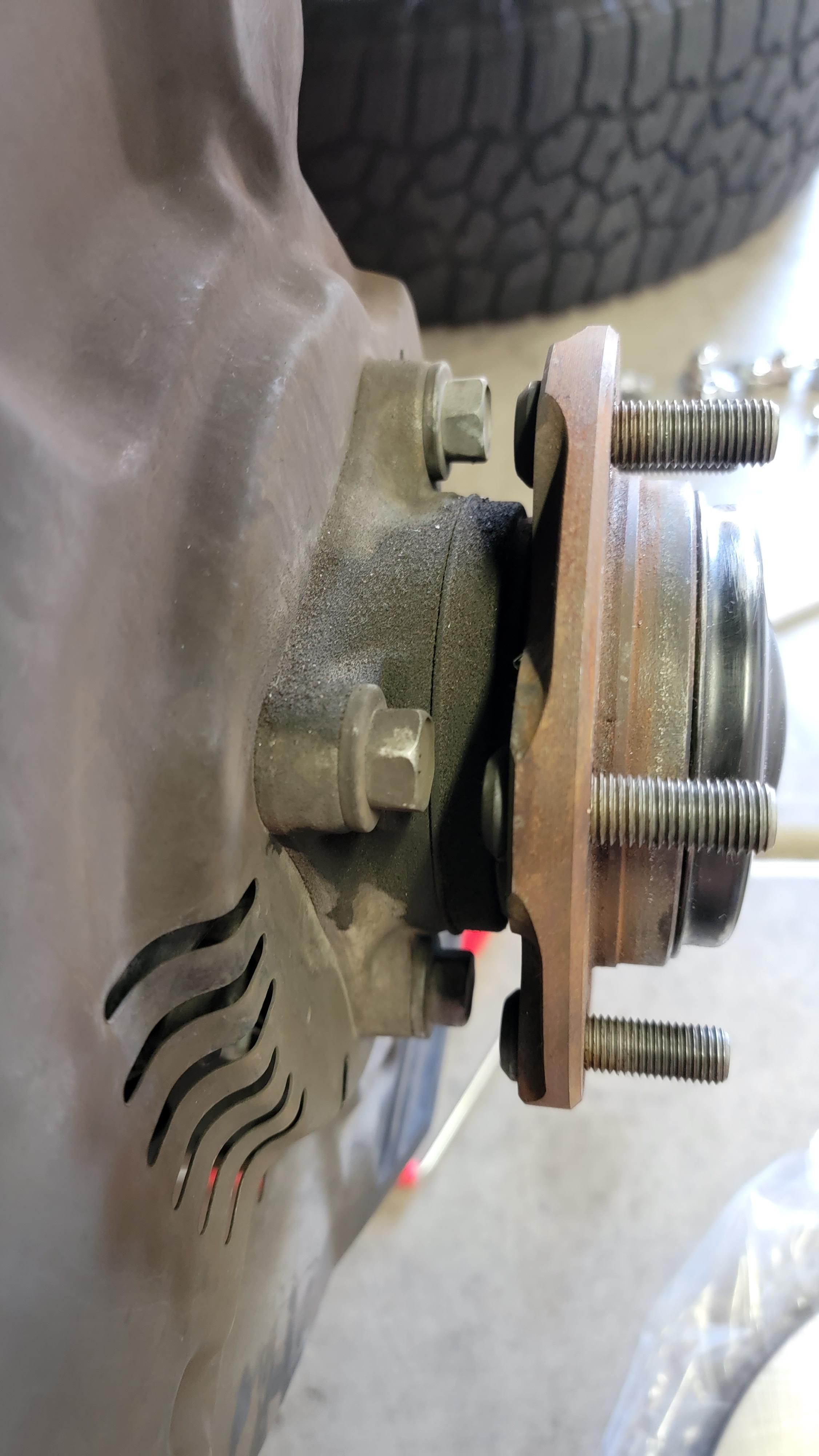

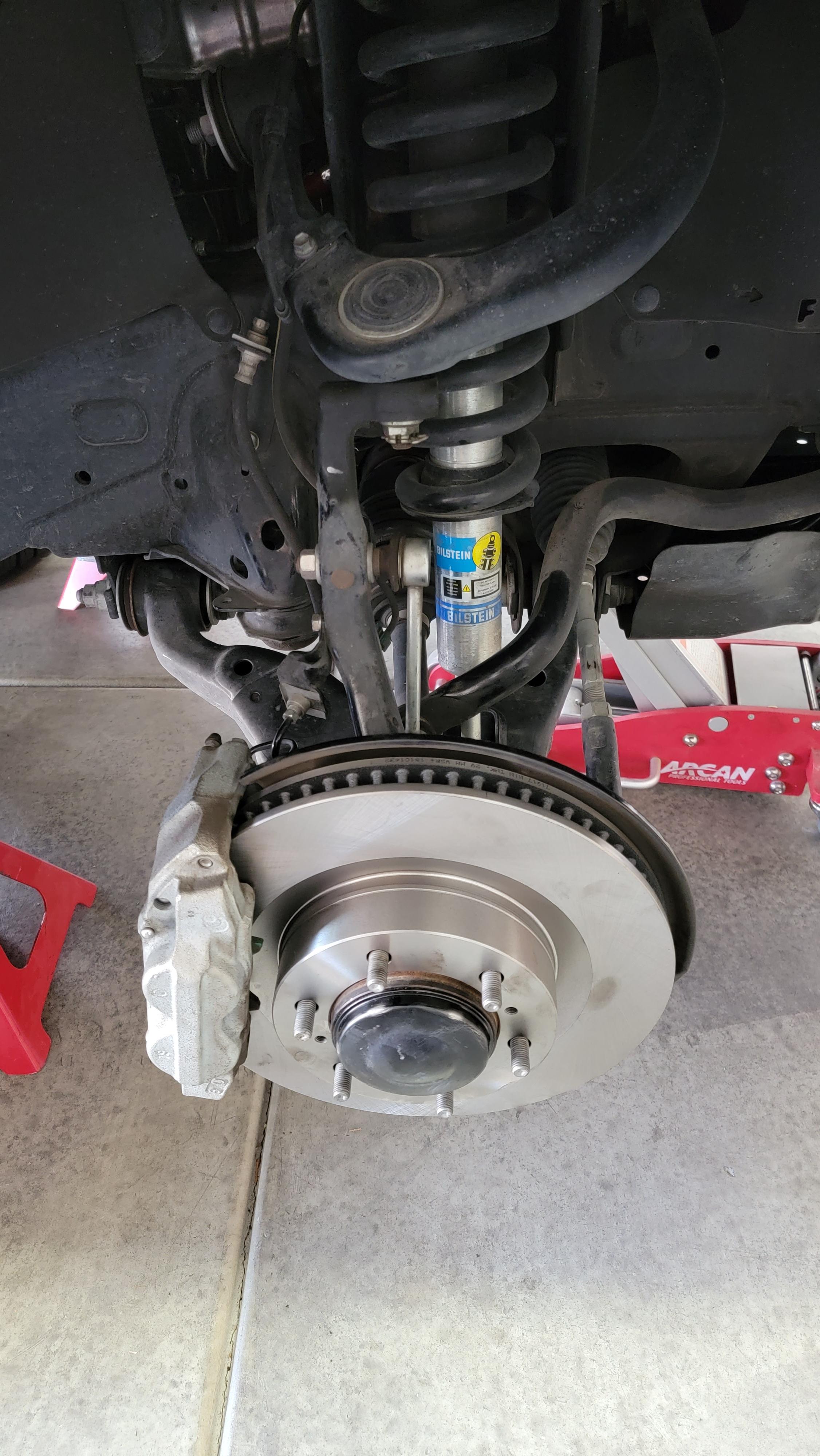

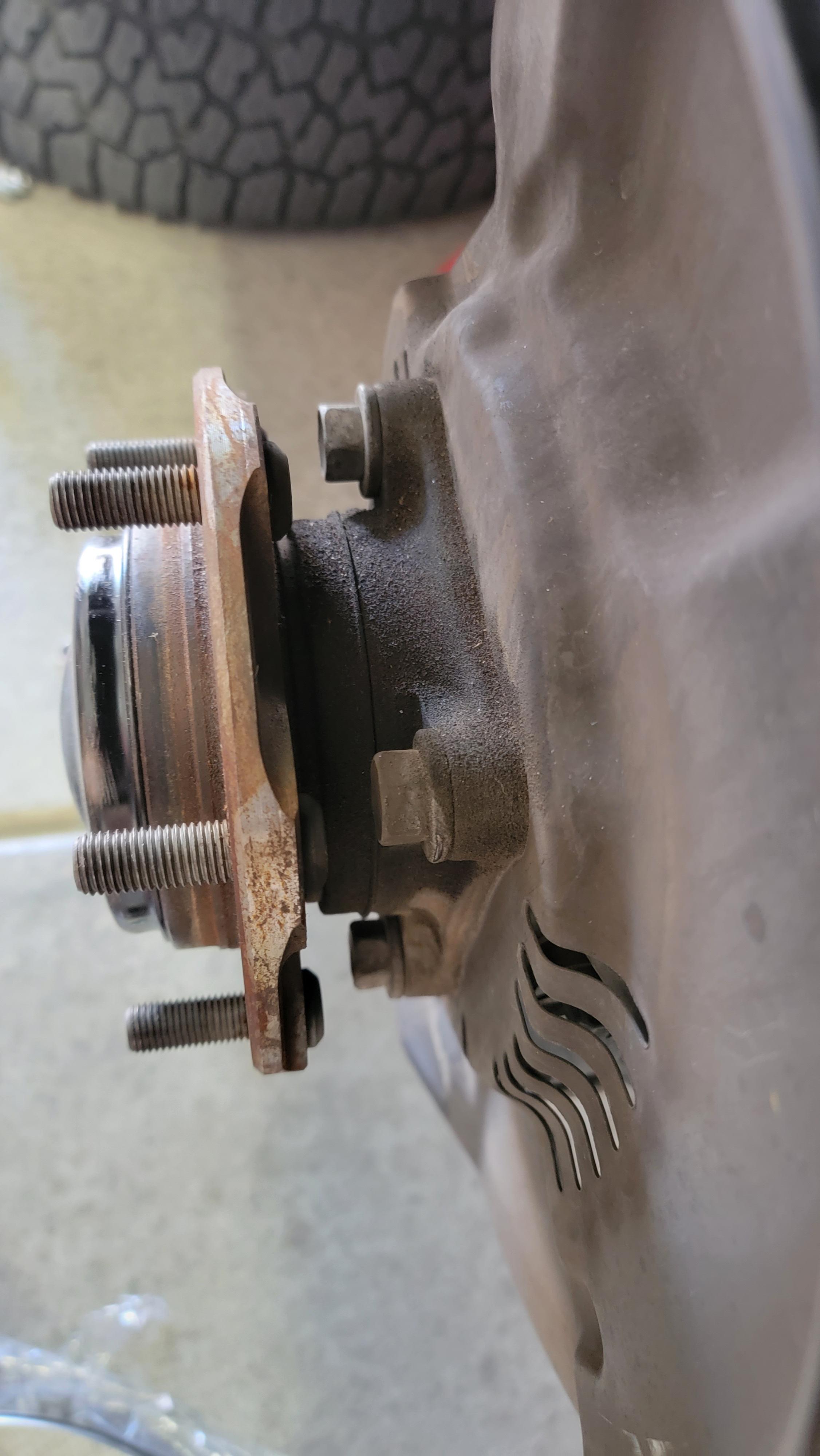

So I'm going down the list trying to get this fixed. Had the tires road force balanced two times now. Went and got an alignment a couple days ago; It's spot on. Swapped out the front rotors today, still shaking. But while I was in there I noticed some grease buildup around the wheel bearing unit. Passenger side has a little more than the driver side. My question, is this normal? Or do you think there's a leak? Bearings are on the list of potential causes of the shake, so they may be next on the list to get swapped out. Appreciate your input. Thanks!
