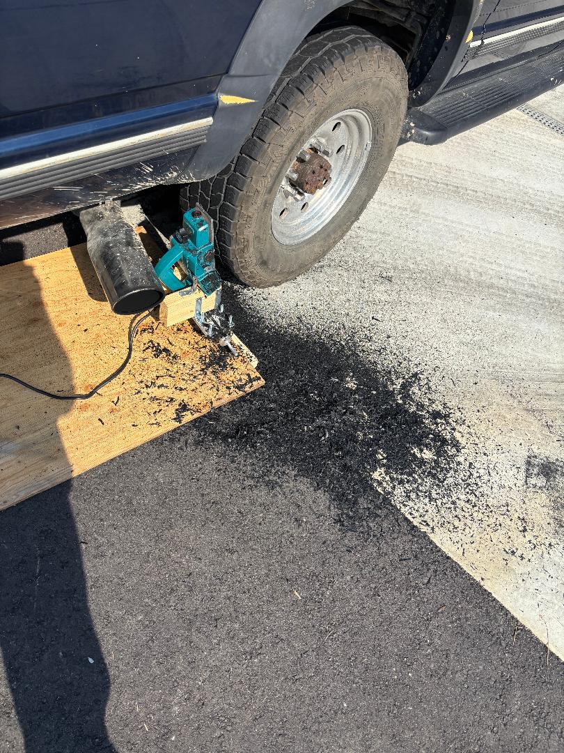

I have had similar vibration at highway speed on my 1999 K2500 Suburban. There it was due to flat spotted tires which happened when wheels were locking up due to the ABS module being out of commission. The vibration was very annoying between 70 and 75 mph. Old timer suggested I shave the tires round again. So I rigged up a Makita planer on a cheap Chinesium milling table attached to a piece of plywood and I shaved the tires. Lo and behold, it worked. This further convinced me that it’s the tires.

A sage old former truck fleet manager suggested shaving them myself. Sent me his video where he used an angle grinder mounted to the cheap mill table. Then he sent others where guys were using a planer. I had a Makita planer up at our Montana home. Ordered the $31 mill table plus extra sets of blades for the planer off Amazon. Fabbed up the set up and I was off and shaving.
I got it to where 95% to 98% of the vibration was gone. Friend said keep going. I stopped because I felt I was at the point of diminishing returns for all the material I would be removing. The vibration is so little now, pretty much only I notice. I think it will scrub out with normal wear and tire rotation.
